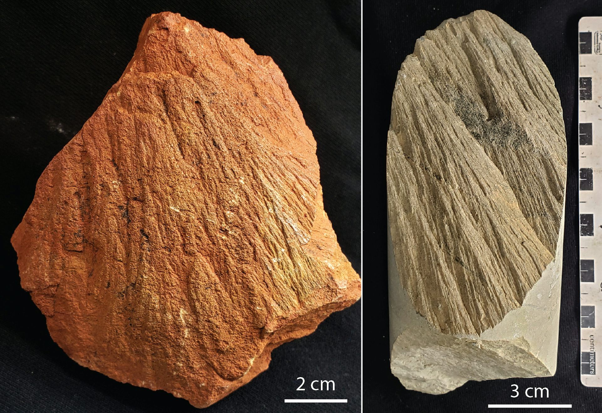

The first evidence for impact we found at Ora Banda was shatter cones – distinctive conical features in rocks that record the passage of the shock wave. We found a few shatter cones in rubbly outcrops at the surface, and we also found some in the drill cores.
The discovery of shatter cones nailed it – we knew then this spot had to be an ancient impact site.

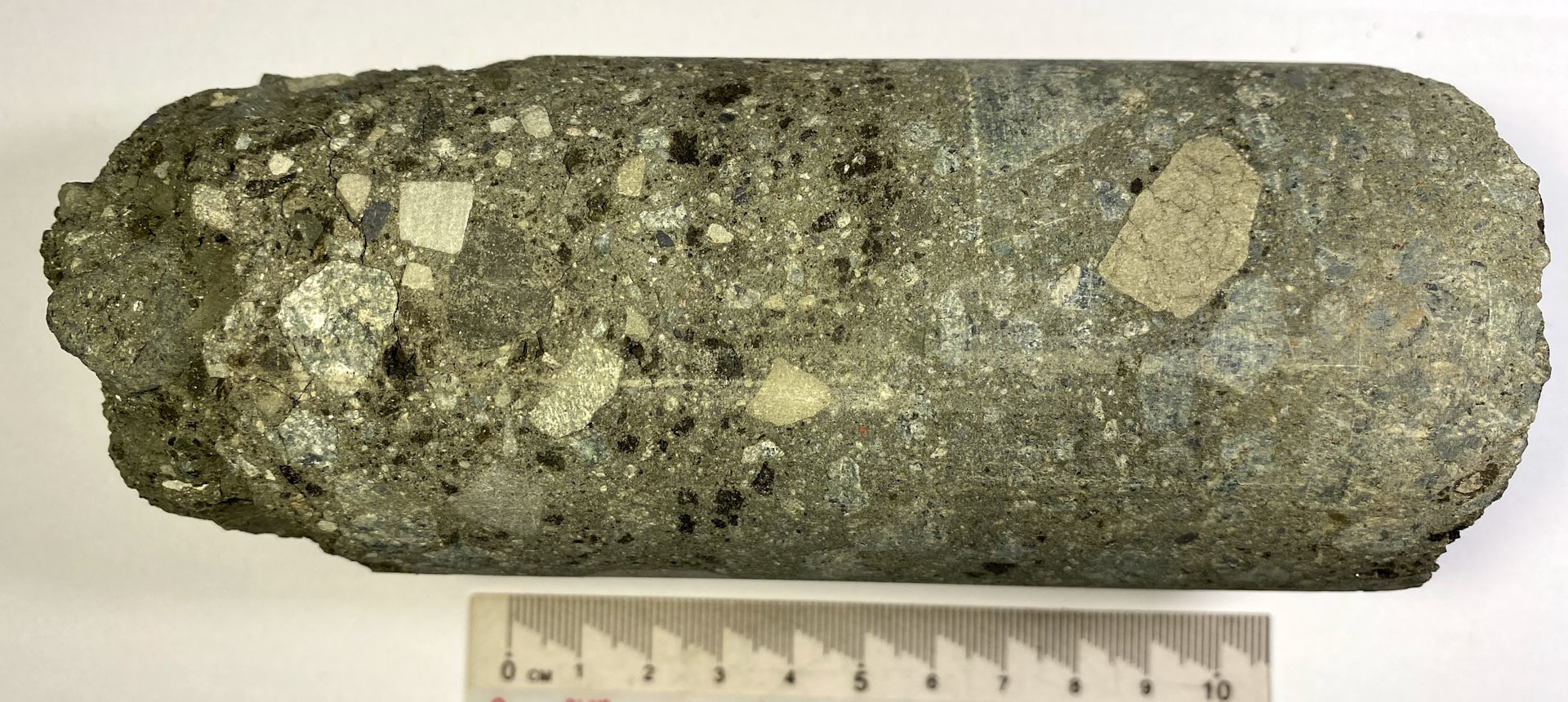

The Ora Banda drill cores contained a range of different rock types. At the top was a sequence of clay-rich sediments – these washed into the crater after it formed. At the bottom were rocks that had a different story to tell: impact breccias.
Breccia is a name for any rock that’s been broken up into smaller fragments and has a matrix of smaller particles that “glue” it all together. Breccias are commonly found at impact craters, because the high-energy shock waves can cause rocks to instantly shatter.
Not surprisingly, there are different types of impact breccias, depending on what they contain.
A breccia is “monomict” if it consists of just one rock type, or “polymict” if it contains pieces of different rocks. Polymict breccias provide strong evidence of mixing, as if the rocks were thrown together in a blender. Both breccia types occur in the Ora Banda cores.
If breccia contains glassy melt particles along with other bits of rock, we call that “suevite”. The glassy bits provide key evidence for an even stranger part of the impact process.
They hint that molten material was thrown up into the sky when the meteorite smashed into Earth. While flying in the air, the molten particles turned to glass before landing back into the newly formed crater, resulting in a layer of suevite breccia.

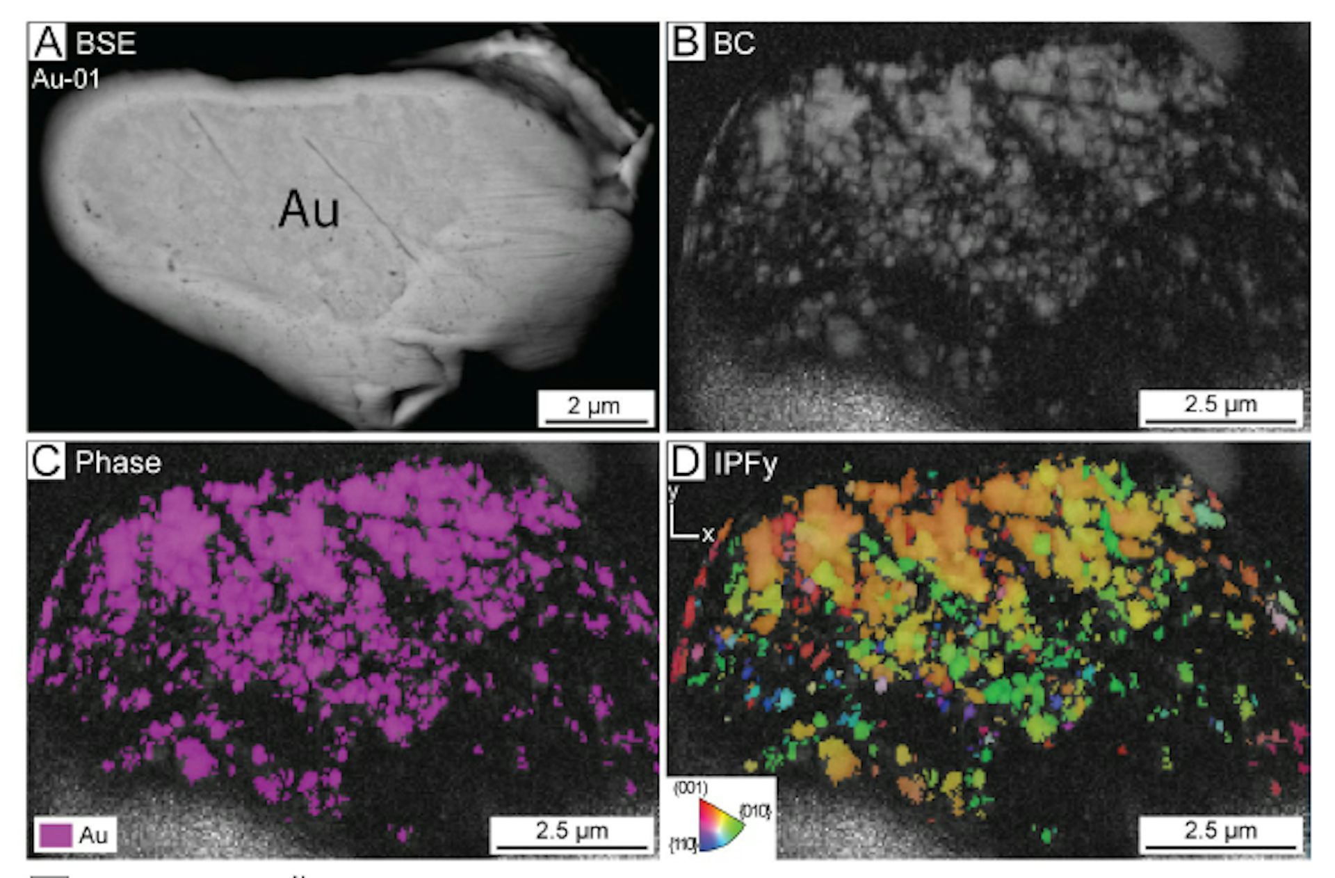

Glass and shocked minerals wasn’t all we found in the Ora Banda breccias. Some also contained small nuggets of gold.
This means that during the impact event, when all the shocked rock fragments and glass were thrown up into the sky, gold particles were also raining back down onto the surface, into the newly formed breccia deposits. That’s not something typically found in impact craters, and it shows how unique this geologic setting is.
