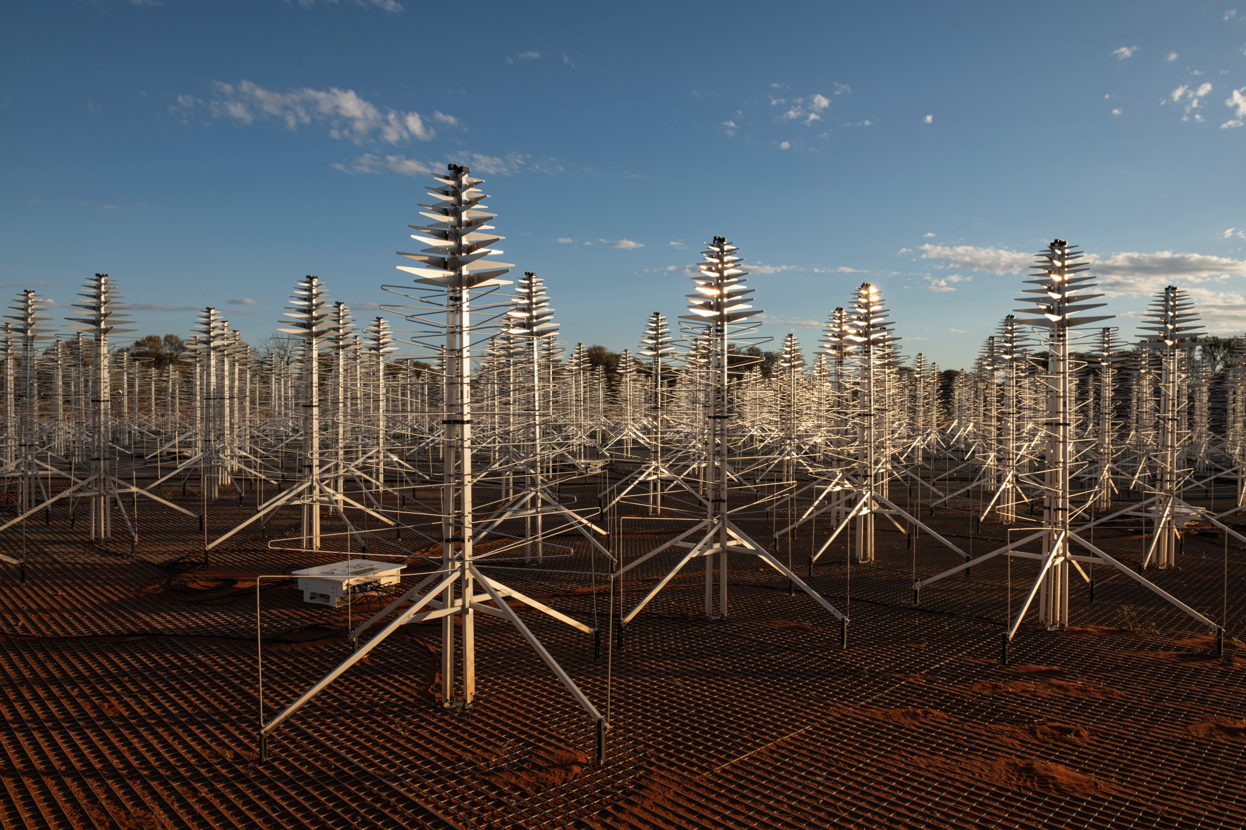

In what researchers are calling the most comprehensive survey of its kind, scientists at Curtin University in Australia have cataloged more than 112,000 unintended radio emissions from Starlink satellites. These emissions now regularly disrupt astronomical observations and may jeopardize the future of radio astronomy.
New study reveals high level of Starlink interference
The study, conducted by the Curtin node of the International Centre for Radio Astronomy Research (ICRAR) and published in Astronomy & Astrophysics, expressed concern over a high level of radio interference from the satellite constellation Starlink. It analyzed 76 million images from a prototype station for the Square Kilometre Array (SKA), soon to be the world’s largest and most sensitive radio telescope. Over just four months, the team detected interference in up to 30 percent of their images, often in frequencies that are supposed to be protected for science.
Study co-author Steven Tingay, the executive director of the Curtin Institute of Radio Astronomy, explains the impact of the interference on the SKA to Astronomy, saying, “For some of the SKA’s science goals, I expect that if the current situation persists, the science will still be manageable. In some areas, the impacts may not be that great. In some other areas, where the science demands the most sensitive observations and contamination-free data, I personally think that the impacts may be significant.”
Starlink, operated by SpaceX, is the largest satellite internet constellation in orbit. Its thousands of spacecraft deliver broadband from space, but as this study shows, they also contribute to a growing source of radio interference. The problem isn’t just Starlink’s size – though the network had over 7,000 satellites in orbit at the time of the study, with 477 new ones launched during the observation period alone – but the way these systems leak radiation.
“Some satellites were detected emitting in bands where no signals are supposed to be present at all,” said Dylan Grigg, a Ph.D. candidate at Curtin and lead author of the study, in a press release. “Because they may come from components like onboard electronics and they’re not part of an intentional signal, astronomers can’t easily predict them or filter them out.”
