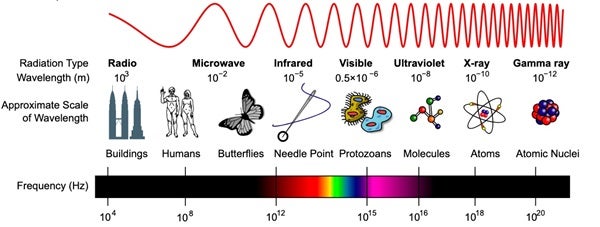

Radio waves are the longest wavelength emissions on the electromagnetic spectrum, meaning that the distance between two peaks of the wave is relatively far apart. Radio telescopes collect radio waves in wavelengths from millimeter to meter wavelengths.

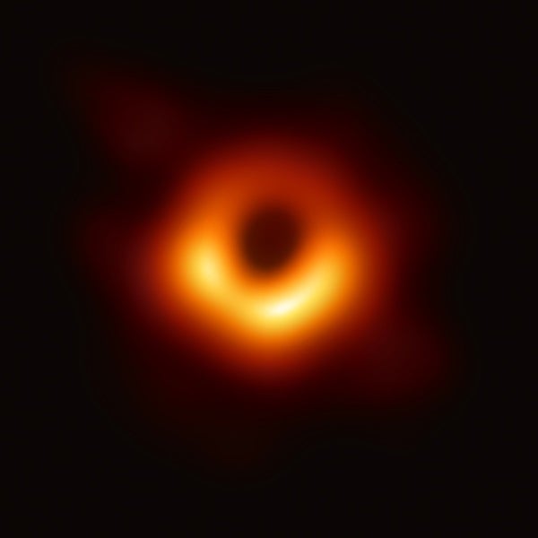

Even if you are unfamiliar with radio telescopes, you have probably heard about some of the research they do. The fantastic first images of accretion disks around black holes were both produced by the Event Horizon Telescope. This telescope is a global network of eight radio telescopes, and each of the individual telescopes that make up the Event Horizon Telescope is located in a place with very little radio frequency interference: a radio quiet zone.

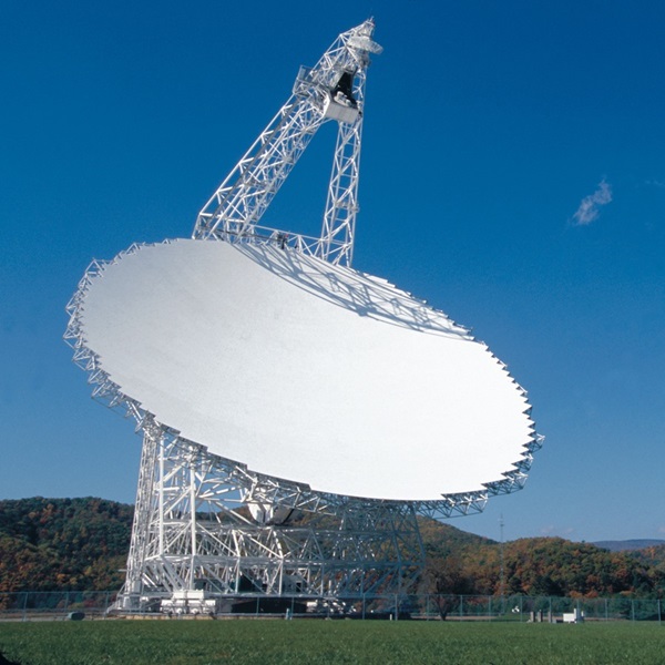

A radio quiet zone is a region where ground-based transmitters, like cellphone towers, are required to lower their power levels so as not to affect sensitive radio equipment. The U.S. has two such zones. The largest is the National Radio Quiet Zone, which covers 13,000 square miles (34,000 square kilometers) mostly in West Virginia and Virginia. It contains the Green Bank Observatory. The other, the Table Mountain Field Site and Radio Quiet Zone, in Colorado, supports research by a number of federal agencies.

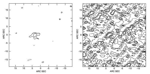

The more radio transmissions there are, the more challenging it becomes to deal with interference in radio quiet zones. Existing laws do not protect these zones from satellite transmitters, which can have devastating effects. In one example, transmissions from an Iridium satellite completely obscured the observations of a faint star made in a protected band allocated to radio astronomy.
