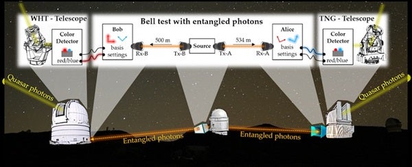

To carry out the study, the team utilized two 4-meter-wide telescopes — the William Herschel Telescope and the Telescopio Nazionale Galileo — located just over half a mile (1 kilometer) apart on a mountain in La Palma, Spain. Both telescopes were trained on different quasars located billions of light-years away.
Meanwhile, at a station between these two telescopes, the researchers generated pairs of seemingly entangled photons — or particles of light — and beamed one member of each pair to a detector at each telescope. As the entangled photons traveled to the detectors, the telescopes analyzed light from the quasars and determined whether the light was more red or more blue than a baseline.
detectorschematic
This graphic shows the experimental setup used to test the freedom-of-choice loophole. Researchers produce two entangled photons (middle) and shoot them in opposite directions toward detectors located at each telescope. The telescope then use ancient quasar light to determine which properties of the photons to measure.
D. Rauch et al. (Phys. Rev. Lett. 121, 080403)
Depending on the measurement, the entangled-photon detectors automatically adjusted the angle of their polarizers, which are devices that measure the orientations of photon electric fields. This allowed the researchers to test whether the photon pairs were truly linked to one another, or if they were just faking it.
