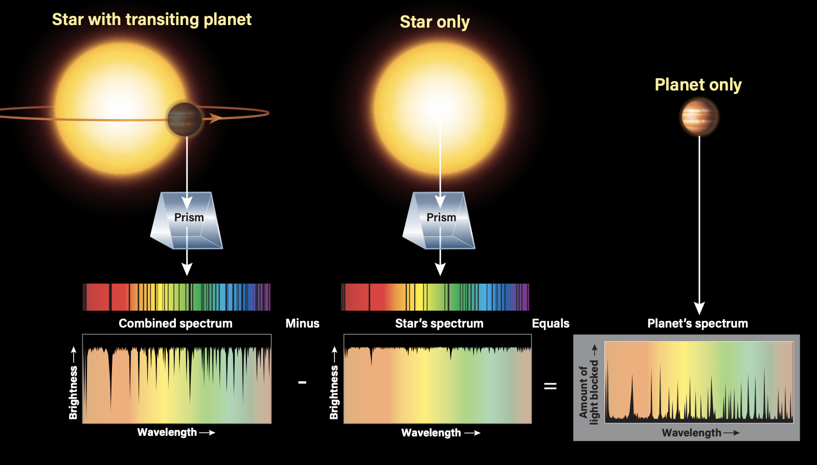

Spectroscopy is the study of how light interacts with matter. Single atoms, for example, absorb light that has wavelengths that match the exact energy required to move their electrons to higher energy levels. On a spectrum, the absorptions appear as distinct dark lines because that color of light disappears.
But molecules — assemblages of multiple atoms — are more complex. This is because they have the ability to absorb wavelengths of infrared light that match the frequencies at which their bonds vibrate (e.g., bend and/or stretch), which depend on their structure. Molecules can also rotate at the same time they vibrate, especially at higher temperatures, which broadens the wavelengths of light they can absorb. This makes the spectral features less distinct and harder to identify.
To determine which unique wavelengths cause a molecule to resonate, researchers fire infrared light at gases in laboratories and analyze the absorption data. To date, molecular spectroscopists have identified the vibrational frequencies of 100 molecules — a tremendous achievement, considering the complex behavior of molecules.

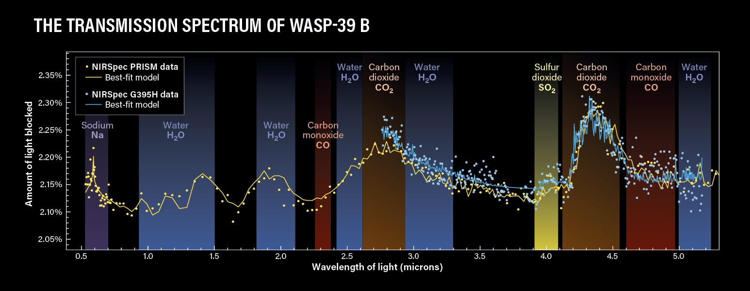

Some of these gases in the spectrum were straightforward to identify. For instance, scientists know that carbon dioxide (CO2) molecules absorb light at a wavelength of 4.26 microns, thanks to lab experiments and calculations conducted by molecular spectroscopists. “Our basic way of building a model of how molecules absorb light is from how it works at room temperature and then performing the calculations for higher temperatures,” says molecular spectroscopist Jonathan Tennyson of University College London. This is helpful for studying hot worlds like WASP-39 b.
Astronomers were also able to identify water vapor (H2O), carbon monoxide (CO), and sodium gas (Na) in the JWST spectrum of the gas giant’s atmosphere.
But they also found a slight dimming at around 4.05 microns that they could not link to any molecule. Their models hadn’t predicted any gases in the planet’s atmosphere that would absorb at that wavelength. But when it showed up again in another JWST spectrum, “we started to feel comfortable that it is real,” says astronomer Jacob Bean of the University of Chicago.
After conducting an exhaustive search of known molecular features, they honed in on a candidate: sulfur dioxide (SO2), a molecule never before seen in an exoplanet spectrum. The JWST observations were a match to lab work and calculations by molecular spectroscopists. But to be confident of their detection, the team had to revisit their models and determine whether it made sense for sulfur dioxide to exist in WASP-39 b’s atmosphere. These models take into account characteristics of an exoplanet like its temperature, pressure, and chemical composition.
But it turned out they were missing a key process: High-energy ultraviolet photons streaming from the WASP-39 host star can break apart water molecules — similar to how sunlight splits oxygen molecules in Earth’s atmosphere to help form the ozone layer. On WASP-39 b, this initiates a series of reactions that could indeed produce sulfur dioxide — and in quantities large enough to explain the spectral feature detected by JWST.
Identifying a gas in an exoplanet atmosphere resulting from complex photochemistry and verifying its plausibility with models “was a spectacular achievement,” says Bean. “The prediction of SO2 required a lot of different pieces of information from different directions.”

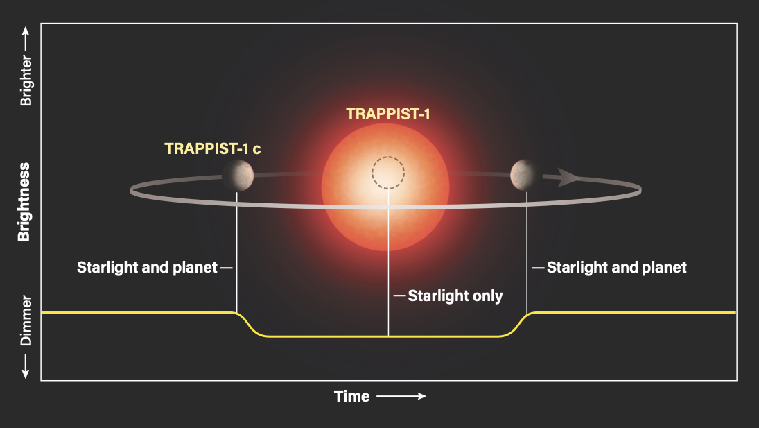

Researchers have already pointed JWST at the two innermost planets orbiting the M dwarf known as TRAPPIST-1. These planets, designated b and c, lie too close to be inside the habitable zone and are too hot for liquid water — but their quick orbits make them low-hanging fruit to see if they have atmospheres.
In addition to transits, JWST has also observed secondary eclipses, when a planet disappears behind its host star. Astronomers can search for signs of an atmosphere by measuring the heat from a planet’s warm dayside just before and after the eclipse. But so far, they have come up empty-handed.

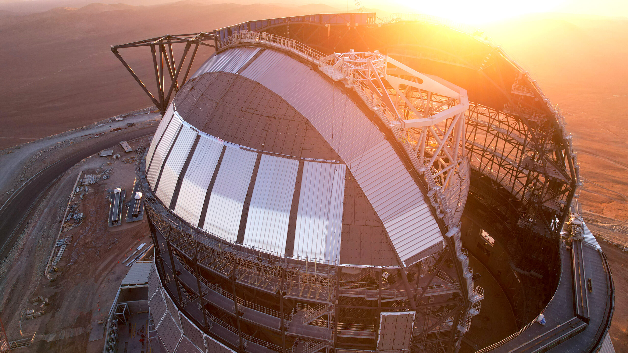

The European Southern Observatory’s 39-meter Extremely Large Telescope, pictured here under construction in Chile in January 2025, is more than halfway complete. When it begins operations — scheduled for 2030 — it will be the largest optical telescope in the world, with an ability to resolve and directly image exoplanets that surpasses that of the James Webb Space Telescope.
The U.S. is funding two telescopes of comparable size — the Giant Magellan Telescope in Chile and the Thirty Meter Telescope (TMT) atop Maunakea in Hawaii. But amid rising costs and budget uncertainty, in 2024, the board of the National Science Foundation (NSF) recommended cutting its support for one of them.
For now, both scopes remain in limbo. A December 2024 report commissioned by NSF did not recommend either facility for advancement to the final design phase, nor did it recommend which one to cut. The report also acknowledged that the future of TMT hinges on the approval of local and Native Hawaiian communities.
