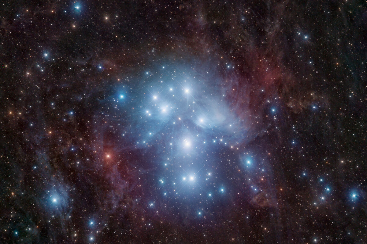

The Pleiades (M45) is one of the finest binocular targets in the sky. Credit: Vikas Chander
Starting off with a bang, our first target is the Pleiades (M45), and it couldn’t be easier to find. Just extend the line from Orion’s Belt that you used to find the V of Taurus and it will lead you to this magnificent open cluster.
At magnitude 1.6, M45 is tied for seventh place in brightness among all deep-sky objects. It’s also deceptively huge. With a diameter of 1.8°, it covers as much area as 12½ Full Moons.
We don’t know why French comet hunter Charles Messier chose to include it in his now famous catalog of nebulous objects that aren’t comets. Even thousands of years before he lived, skywatchers knew it wasn’t a comet. In fact, the Greek astronomer Eudoxus, who lived in the 4th century b.c.e., referred to the group as the Clusterers, and considered it a constellation.

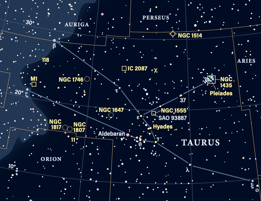

Use this chart to locate the deep-sky objects mentioned in the story. Credit: Astronomy: Richard Talcott/Roen Kelly
One of the most popular names for M45 is the Seven Sisters. This implies that there are seven visible stars in this group, but human eyesight varies a lot. The majority of people can only see six stars, but if you have great eyes and are at a dark site on a night of good seeing (atmospheric steadiness), you may be able to identify 10 or more Pleiades.
Probably the best way to observe this cluster is to use binoculars. Any will give good views, but the finest come from high-quality 7×50, 10×50, and 11×80 instruments.
If your observing site is dark, try to see the Merope Nebula (NGC 1435). This reflection nebula surrounds (in an irregular way) the star Merope (23 Tauri). I’ve seen it through a 4-inch scope using a magnification of 30x, but it was tough. A larger aperture will certainly help, but keep the power low.

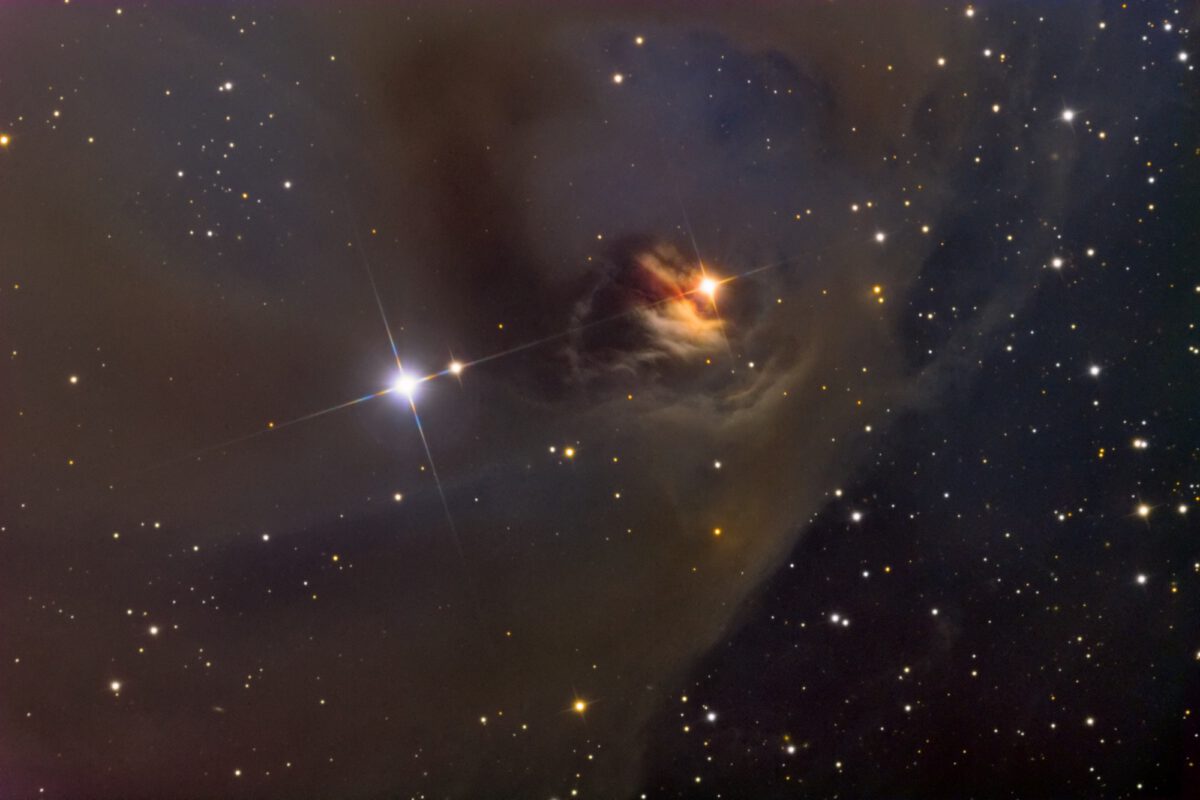

Hind’s Variable Nebula (NGC 1555) surrounds the star T Tauri. It’s a tough catch, so use the largest telescope you can to spot it. Credit: Adam Block/Mount Lemmon Skycenter/University of Arizona
Now we come to an object that you’ll need at least a 14-inch telescope to spot. It’s Hind’s Variable Nebula (NGC 1555), named in honor of its discoverer, British astronomer John Russell Hind, who found it in 1852.
NGC 1555 is a reflection nebula that we see because of its location near T Tauri. There’s a problem, though. T Tau is a variable star. Usually, its magnitude hovers around 10, but it can dip to 14 and stay there for a year or more. This is why it’s called Hind’s Variable Nebula. When T Tau is at minimum brightness, you have no hope of spotting the nebula.
Finding Hind’s Variable Nebula is a two-step process. First, look 1.7° west-northwest of Epsilon (ε) Tauri and locate SAO 93887, which glows at magnitude 8.4. Second, nudge your scope 5′ to the northeast of that star, and you’ll find T Tau. Next to it (if your scope is big enough and your night clear enough), you’ll hopefully see an unevenly lit wedge of light. That’s NGC 1555.

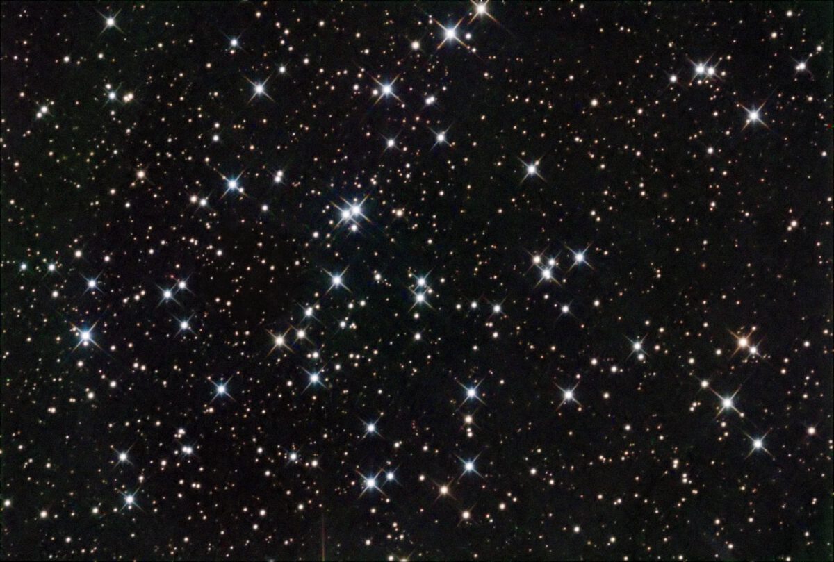

The Pirate Moon Cluster (NGC 1647) is an open cluster that lies some 1,800 light-years from Earth. Credit: Gerald Rhemann
Now turn your gaze to the Pirate Moon Cluster (NGC 1647), which glows at magnitude 6.4 and measures 45′ across. To find it, point your scope 3½° northeast of Aldebaran. If the seeing at your site — and your eyes — are good enough, you might be able to spot a fuzzy patch without optical aid. The best way to observe NGC 1647 is through an 8-inch or larger telescope. If you start with the eyepiece that gives you the lowest magnification, the cluster should be nicely framed within the field of view. Then spend some more time with it as you crank up the power and split half a dozen or more double stars.

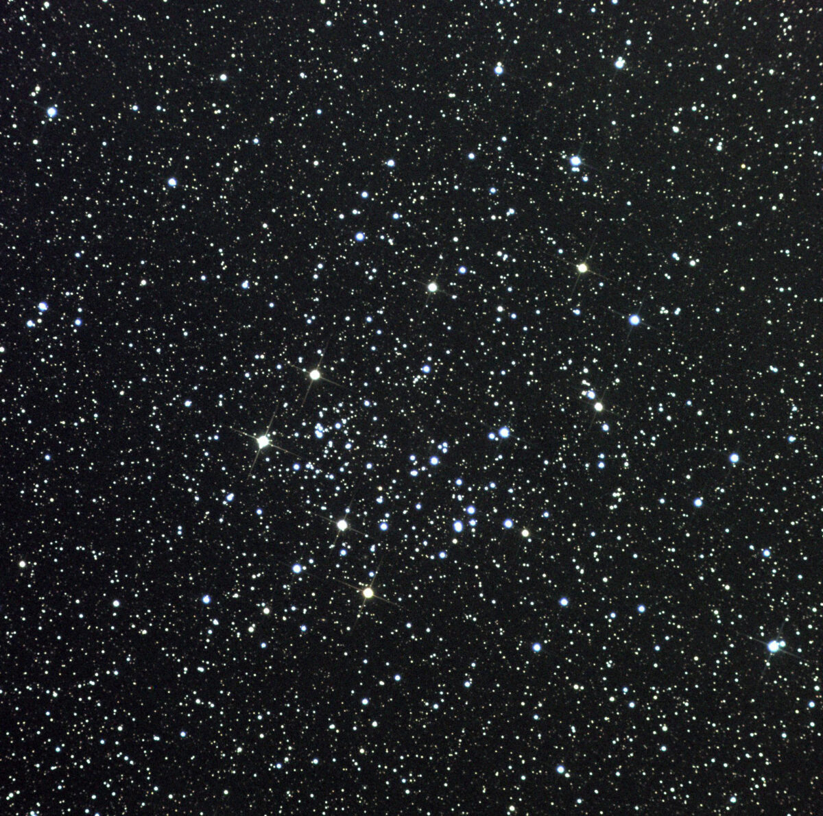

Although NGC 1746 is a cluster of stars, it’s now classified as an asterism rather than a true open cluster. Credit: Egres73/Wikimedia Commons/CC BY-SA 3.0
Now it’s time to encounter open cluster NGC 1746. At least, that’s how it was designated shortly after it was discovered in the middle of the 19th century. Further study has revealed that NGC 1746 is actually a pair of clusters, one in front of the other. The closer one, NGC 1750, lies roughly 2,000 light-years away, while the farther one, NGC 1758, is 2,500 light-years distant. Because the two clusters aren’t physically related, NGC 1746 is now classified on most lists as an asterism. You’ll find it a bit more than 2° north of Iota (ι) Tauri.
When you observe NGC 1746, you can pretty much tell which stars are in which cluster, mainly because all the stars in each region have the same brightness. So, the (apparently) brighter dozen or more belong to NGC 1750, and the fainter field stars are in NGC 1758.

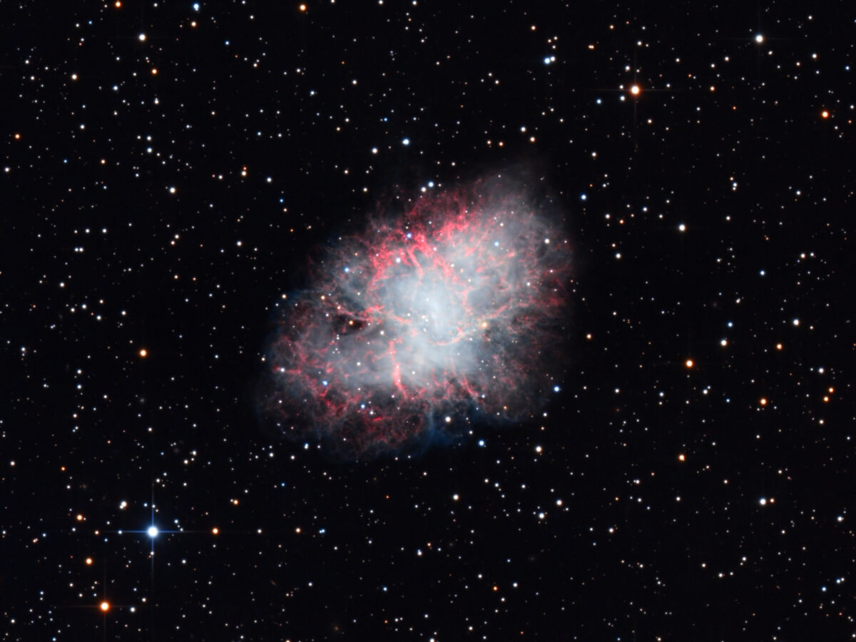

The Crab Nebula (M1) got its name after William Parsons, Earle of Rosse, sketched it in 1843. He didn’t name it, however. Other astronomers noticed the nebula’s resemblance to a crab. Its outer layers are zooming into space at more than 900 miles per second (1,450 km/sec). Credit: Sergey Trudolyubov
The final target on our list is the first entry in Messier’s list — M1. It’s also known as NGC 1952, but most observers call it the Crab Nebula. To find it, look 1° northwest of Zeta Tauri.
M1 is a supernova remnant, an expanding shell of gas formed when a supergiant star exploded. It was first seen by Chinese astronomers in 1054, and it could be seen for a year before fading away. What amateur scopes reveal now is a whitish rectangular cloud that measures 6′ by 4′ and glows at magnitude 8.4.
Because of its high surface brightness, the Crab takes high magnification well. So, crank up the power until the image starts to break down because of sky conditions, and look for its irregular border and darker areas across its face.
