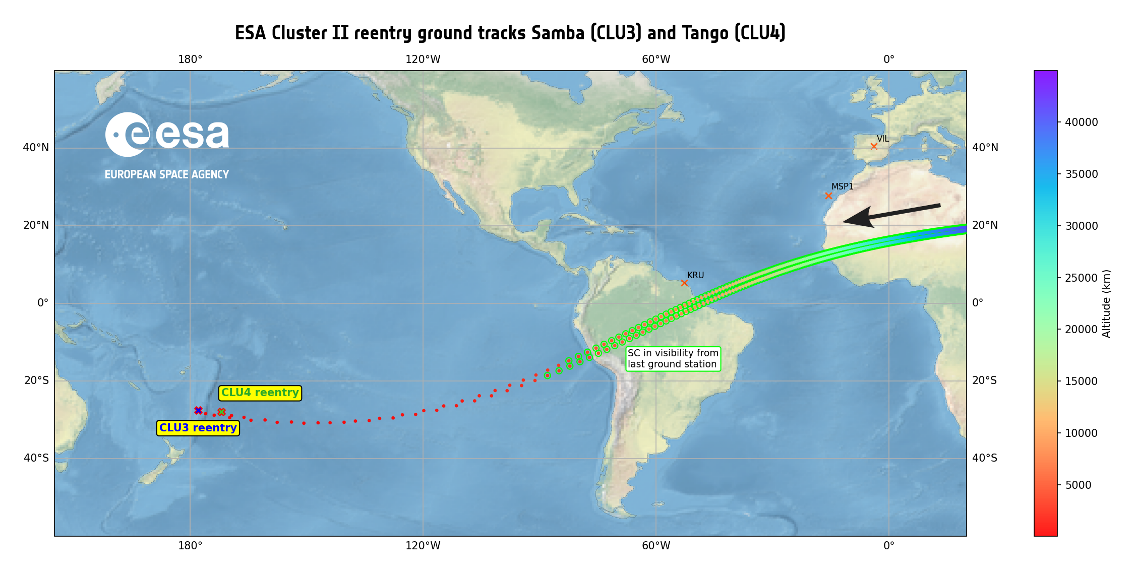

ESA’s Samba spacecraft reentered the atmosphere on Aug. 31 at 5:39 p.m. EDT, disintegrating over a remote section of the South Pacific Ocean. Tango, the last of the four Cluster satellites, followed less than 24 hours later, on Sept. 1 at 5:30 p.m. EDT. Both reentries had been planned years in advance to happen at predictable locations — precise enough that a team of scientists could fly a small plane towards the event and record each satellite’s demise. The team recorded nearly a full minute of each reentry with dozens of instruments.

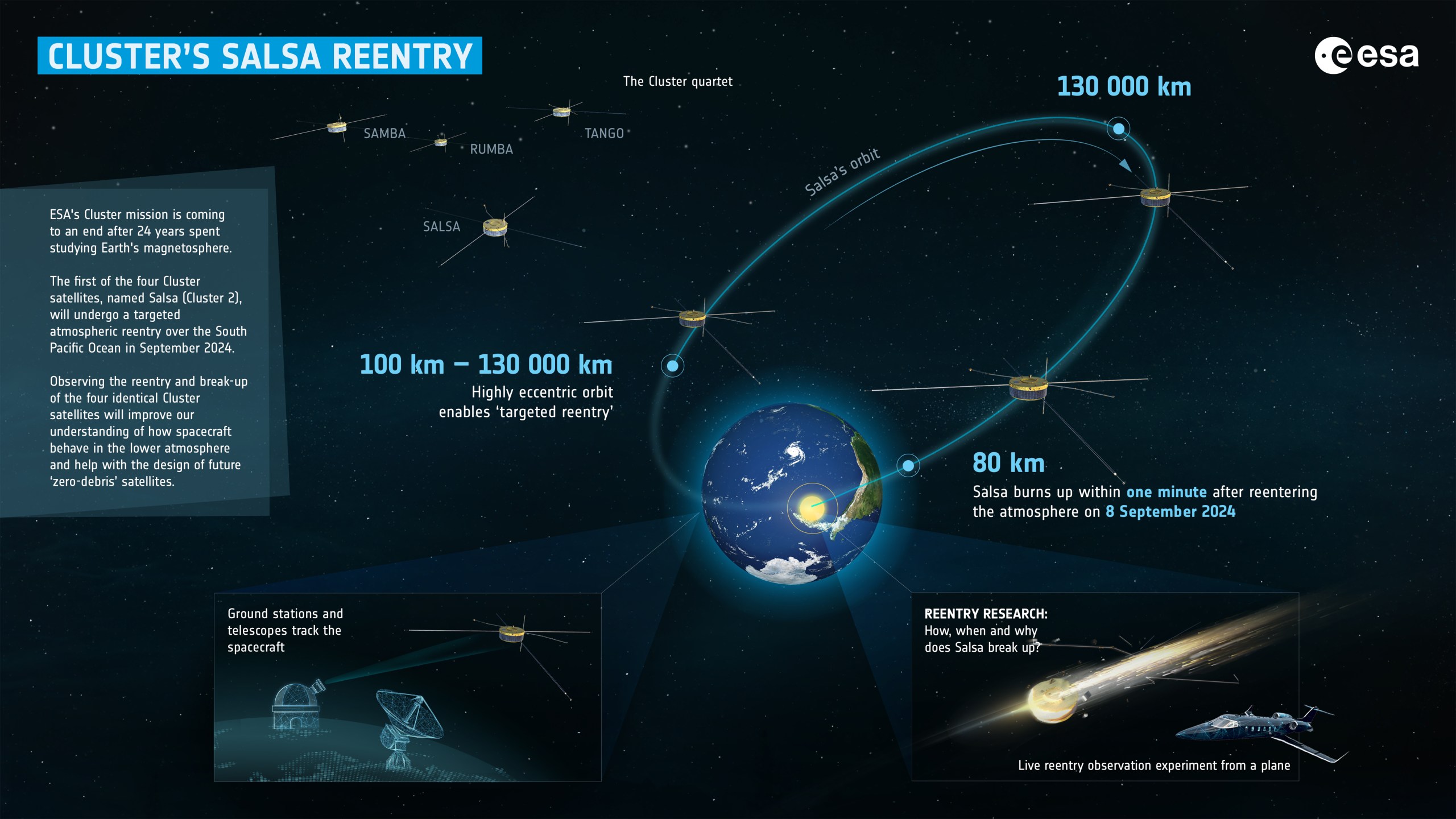

But Cluster’s satellites flew in higher, elliptical orbits, swinging past Earth at their closest approach — called perigee — every 2.5 days before climbing back out toward apogee, nearly 80,000 miles (130,000 km) away. That wide, looping orbit kept them free from the effects of atmospheric drag for the most part. However, their orbit was impacted by the gravitational pull of the Sun and Moon. Small gravitational tugs could shift perigee from one pass to the next by as much as 19 miles (30 km). The satellites’ orbits moved through 12-year cycles, with perigee drifting closer to Earth, then farther away. At some point in that cycle, perigee dropped enough that a single pass plunged the satellites so low that atmospheric drag and Earth’s gravity took over and the satellite reentered the atmosphere. Fortunately, scientists were able to predict when that pass would take place and exploit it. In November 2024, ESA’s flight dynamics team fired a handful of small thruster burns to nudge Samba and Tango’s trajectories, so that when the satellites reentered, they would do so over a remote, uninhabited stretch of the South Pacific Ocean where an airplane full of researchers would be waiting.

Salsa became the first target of an airborne observation campaign when it reentered in September 2024, followed by Rumba in October 2025. The reentry of Salsa “has already produced intriguing results,” Lemmens said. For one, the expected atmospheric density during reentry differed from predictions by about 20%, which Lemmens attributes to uncertainties in the upper atmosphere. These discrepancies can reduce accuracy in forecasting when satellites will reenter. Salsa also started to disintegrate earlier than models predicted.

On Aug. 31, the crew flew out from Tonga to reach Samba’s reentry point. Back at ESA’s mission control in Darmstadt, Germany, flight controllers sent Samba a last round of commands and said their goodbyes; the spacecraft’s final telemetry went silent about 13 minutes before reentry.
At 5:39 p.m. EDT, Samba streaked into the atmosphere exactly as predicted, and the plane’s 30 instruments — including tracking cameras, spectrometers, and visual and infrared sensors — followed its breakup across the sky for roughly 50 seconds. The team then flew back to Tonga and prioritized sleep over reviewing footage.
The next day brought the same routine. Controllers said their final farewells to Tango and lost its last telemetry about 15 minutes before reentry. This time, the plane’s pilot banked at just the right moment to hold the burning satellite in frame a few seconds longer.
Tango reentered at 5:30 p.m. EDT on Sept. 1 — again matching the prediction almost to the second — bringing 26 years of Cluster operations to a close. 29 of the 30 instruments captured usable data on both nights, recording which materials melted, and when, as each satellite came apart. Now that the data is in, the team will have to sort through it. Matching signal and camera frame from the instruments to the right piece of spacecraft will take the ROSIE team weeks, if not months.
