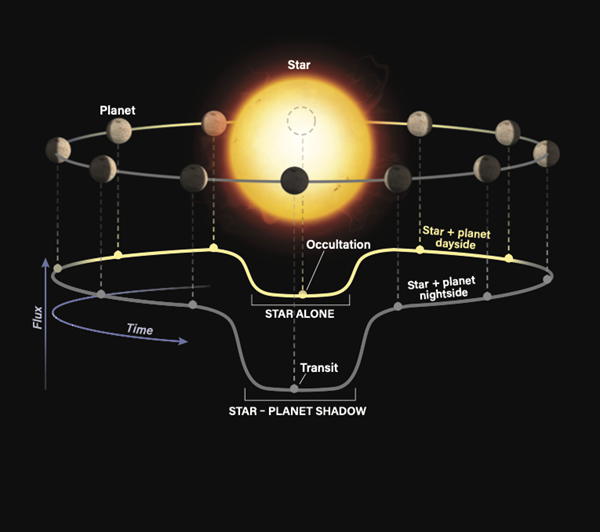

TESS identifies extrasolar planets by watching for dimming events associated with transits, which occur when a planet crosses the face of its host star as seen from Earth. The satellite is also sensitive enough to see occultations — when an orbiting planet passes behind its host star, slightly dimming the total light we receive.
Astronomy: Roen Kelly, after Josh Winn (2010)

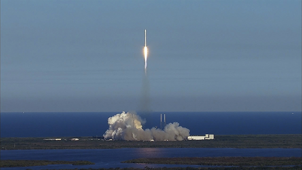

A SpaceX Falcon 9 rocket carries TESS aloft from Cape Canaveral Air Force Station in Florida at 6:51 P.M. EDT on April 18, 2018.
NASA/KSC

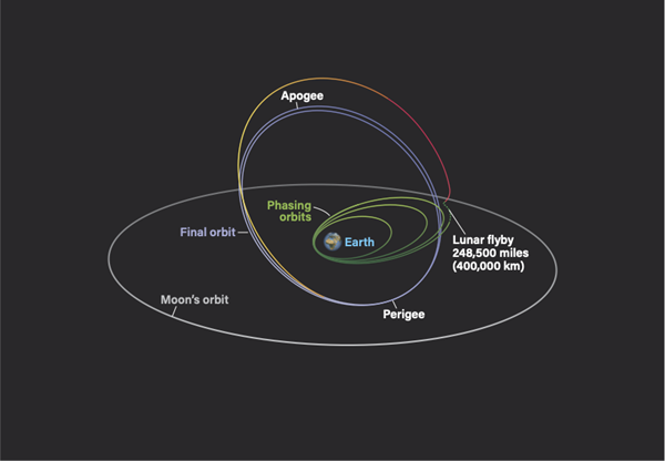

TESS’S P/2 Orbit
TESS’s unique 13.7-day orbit around Earth puts the satellite in a 2:1 resonance with the Moon, meaning the spacecraft completes two orbits for every one orbit of our Moon. During that time, TESS comes as close to Earth as 67,000 miles (107,800 km) at perigee and swings as far away as 232,000 miles (373,400 km) at apogee. To reach this orbit, TESS underwent a series of three transfer orbits and a lunar flyby, ultimately arriving in its final P/2 orbit 42 days after launch.
Astronomy: Roen Kelly, after Ricker et al. (2014)

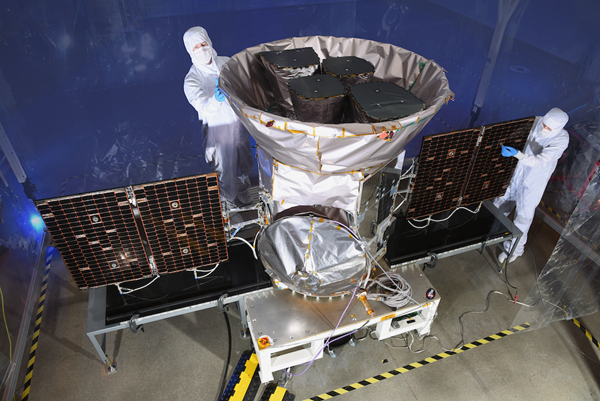

Each of TESS’s CCD cameras, visible here as four cones with black covers at the top of the spacecraft, has a 24° by 24° field of view and functions as 64 million tiny light meters. Each pixel is 15 micrometers square.
Orbital ATK
The most critical bit of mission planning was selecting an orbit for TESS that would provide a view free of obstacles — namely, Earth. TESS needed to continuously monitor a huge field of view (more than 2,000 square degrees) for weeks at a time. In order to find planets, it would need to see at least two or three transits — and a transit of a small planet might only last one or two hours every couple of weeks. Based on this data collection rate, TESS would also need to downlink enormous numbers of images for ground-based observers to search.
Orbits very distant from Earth — like Kepler’s 6.2 million-mile (10 million kilometers) heliocentric orbit or JWST’s planned 900,000-mile (1.5 million km) orbit around the Earth-Sun Lagrange 2 point — seemed desirable. But communicating from those distances would exceed any reasonable budget of antenna time a small mission could expect from NASA’s Deep Space Network.
The solution turned out to be a new kind of elliptical orbit, in which the satellite spends part of its time close to Earth for data downlink but most of its time at a distance comparable to the Moon’s distance from Earth. Generally, such orbits are notoriously unstable and can result in a spacecraft crashing into either the Moon or Earth within a couple of years. Our unique solution turned out to be an almost magical orbit in a favorable 2:1 resonance with the Moon’s orbit around Earth. Since this specific so-called P/2 orbit had never been used previously in a space mission, our team spent an enormous amount of time analyzing how to establish and maintain it.
ASYTS0821_06

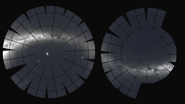

At the completion of its primary mission, TESS had mapped about 75 percent of the sky. Here, its complete view of the Southern Hemisphere appears at left and the Northern Hemisphere at right. The regions missing from the Northern Hemisphere map are areas TESS did not observe, to avoid picking up stray light from Earth or the Moon.
NASA’s Goddard Space Flight Center
To be sure of our results, we had two different groups — one at The Aerospace Corporation and one at NASA Goddard — work independently on the calculations. In the end, our P/2 orbit was both elegant and practical. It even offered several major advantages, some of which surprised us — especially the excellent thermal stability of our cameras and the low radiation levels experienced by the spacecraft. Other advantages included high downlink rates and low stray background light.

On April 18, 2018, a SpaceX Falcon 9 rocket carrying TESS roared into space. TESS arrived in its final P/2 orbit 42 days later, and our primary mission’s first survey observation began July 8. Over the next two years, TESS’s four wide-field CCD cameras systematically stepped across the sky. During the first year, TESS observed 13 Southern Hemisphere “sectors” 24° by 96° in size for 27.4 days each. In its second year, TESS switched to observing 13 equally sized sectors in the northern sky.

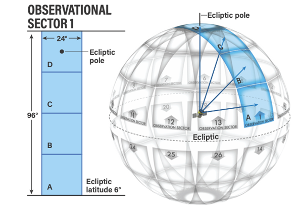

TESS divides each hemisphere of the sky into 13 distinct observational sectors measuring 24° by 96° each, observing a total of 26 sections between both hemispheres. The satellite views each sector for two orbits — a total of 27.4 days — before moving on to the next.

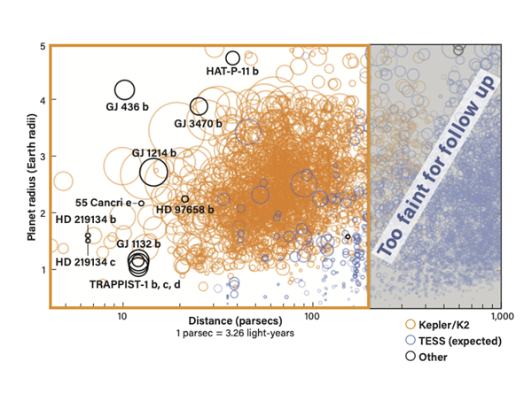

The TESS Follow-up Observing Program (TFOP), coordinated by our colleagues at the Smithsonian Astrophysical Observatory, is a worldwide effort of more than 550 astronomers at 100 institutions. These researchers sort through and follow up on this rich trove of TOIs using roughly 250 telescopes. TFOP astronomers have whittled down the 3,000 or so TOIs to about 100 so-called Level 1 confirmed TESS exoplanets. These Level 1 planets are all small, with radii less than four times that of Earth. Combined with the masses measured by the TFOP teams, we have confirmed that these small planets are indeed super-Earths and their slightly larger cousins with thicker atmospheres, sub-Neptunes. Furthermore, an important subgroup of these Level 1 planets is Earth-like in both size and mass.
ASYTS0821_15
The TESS mission serves a unique function by identifying small extrasolar planets with radii just a few times that of Earth around bright, nearby stars. These particularly accessible host stars allow researchers to more easily and quickly follow up on newly discovered planets using ground- and space-based telescopes.
Zach Berta-Thompson
sizes among the TESS planet candidates. And about 25 percent of TOIs are not planets at all, but distant eclipsing binary stars, whose eclipses can mimic exoplanet transits. Ongoing observations with higher-angular resolution telescopes, such as the Gaia space mission, will allow astronomers to separate these systems from real transiting planets.
