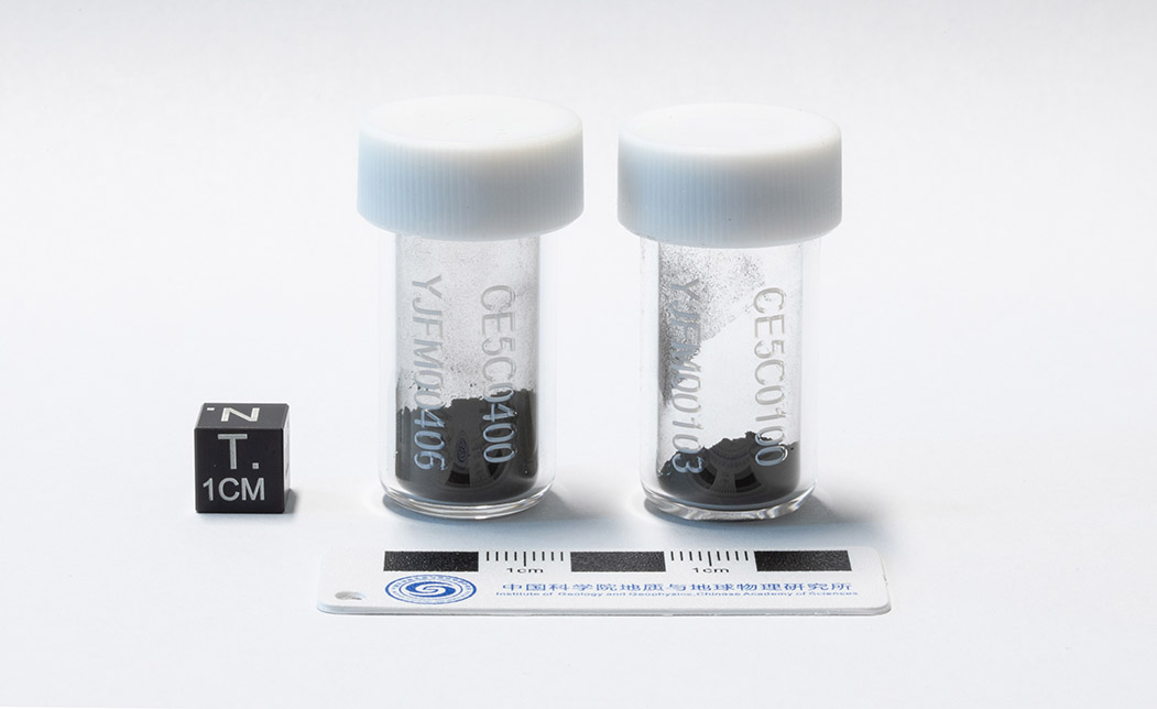

The small amount of lunar soil used to recover the 3,000 glass beads analyzed by Wang and his associates is demonstrated by the small sample vials. Credit: Chinese National Space Administration
