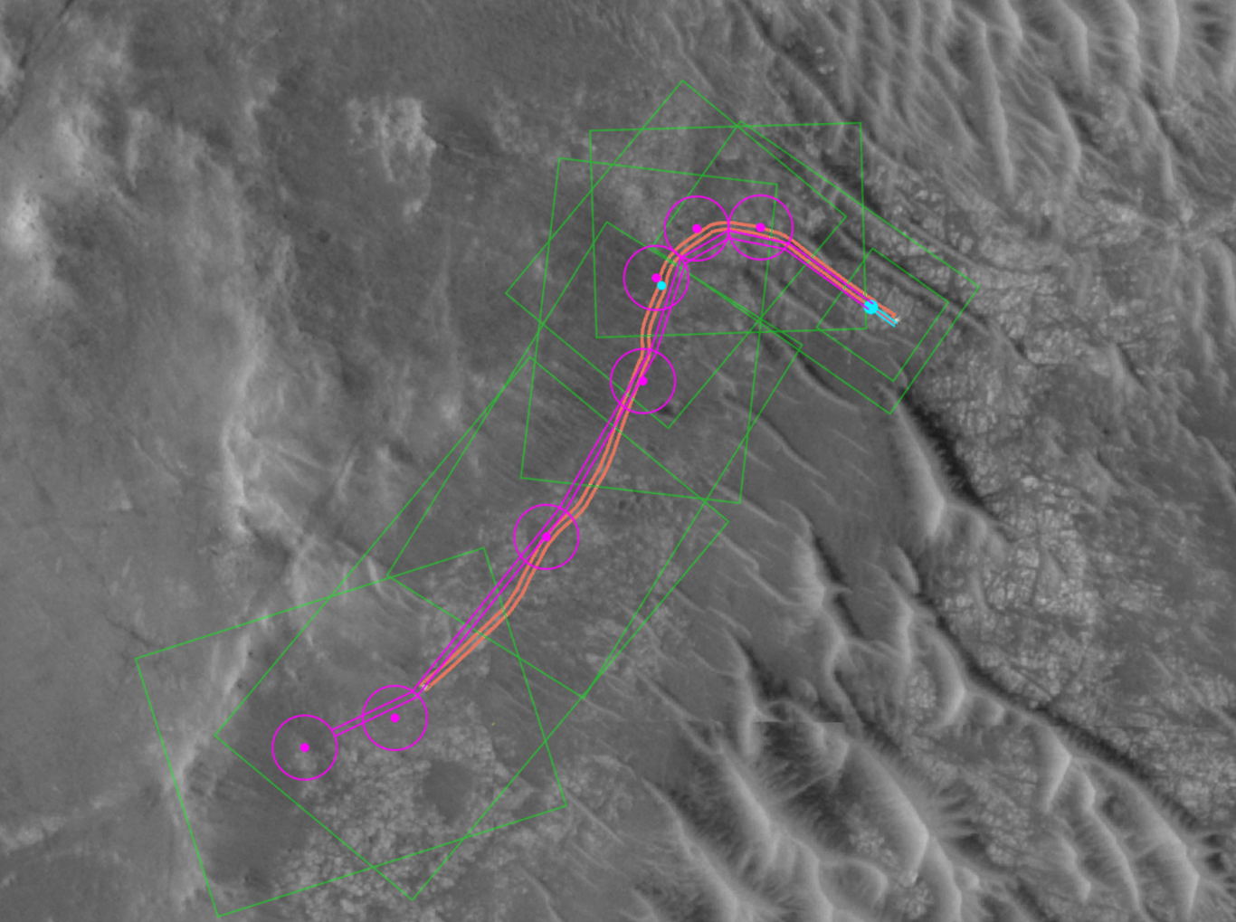

During the rover’s operations on Dec. 8 and 10, the ROC team, in collaboration with AI company Anthropic, sent the rover a route completely planned by a generative AI that used Anthropic’s AI model known as Claude. The AI used imaging from the HiRISE (High Resolution Imaging Science Experiment) camera on the Mars Reconnaissance Orbiter and other data gathered from the martian surface to plot a series of waypoints that avoided potential hazards.
Planning this drive wasn’t as simple as asking a chatbot to write an email. The JPL team utilized an interface called Claude Code — a tool aimed at software developers — to upload a large amount of previous mission data. This gave the AI the context it needed to understand the martian surface. Claude then used its vision capabilities to analyze the data and stitch together several roughly 32-foot (10-meter) segments separated by waypoints. The model reviewed its work, edited the waypoints for safety, and finally converted the entire plan into “Rover Markup Language” —  the specialized coding language NASA uses to communicate with its deep-space hardware.
Reviewing the route
To verify the AI’s work, the ROC team ran these commands through a rigorous simulation involving a virtual version of the rover and over 500,000 variables to predict any hazards along its route. The team made a few manual tweaks, then the finalized directions were sent through NASA’s Deep Space Network to Perseverance. On Dec. 8, the rover drove 689 feet (210 meters), guided by Claude’s route. On Dec. 10, it continued an additional 807 feet (245.9 meters), bringing the total trip length to 1,496 feet (455.9 meters).
