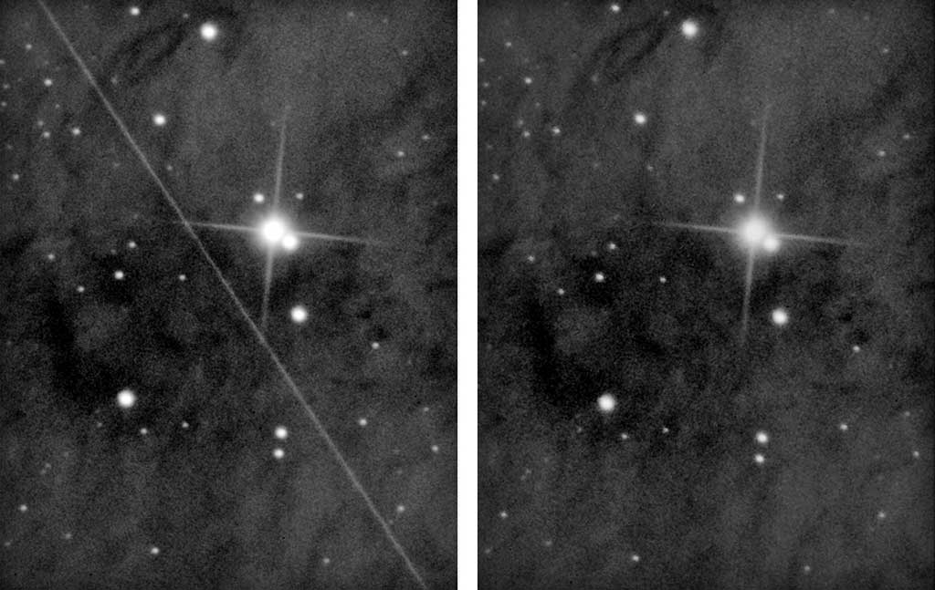

Satellite-trail
A bright satellite trail goes through this segment of galaxy cluster Abell 2151. Note that it bisects a star (above center) and a small galaxy that lies to the star’s right. Both images Tony Hallas
2  Go to one end of your satellite trail and, just beyond and to one side of it, left-click the tool. A little circle will appear next to the tool showing that you established an anchor point. Once you make the anchor point, drag the mouse along the satellite trail to create a selection line.

Abell-2151
Abell 2151 looks much better in the author’s final image. After making a selection around the satellite trail and deleting that selection, he used Photoshop CS5‘s “Content-Aware Fill” menu selection to replace the trail with background data. This removed the obstruction from both the star and the galaxy.
