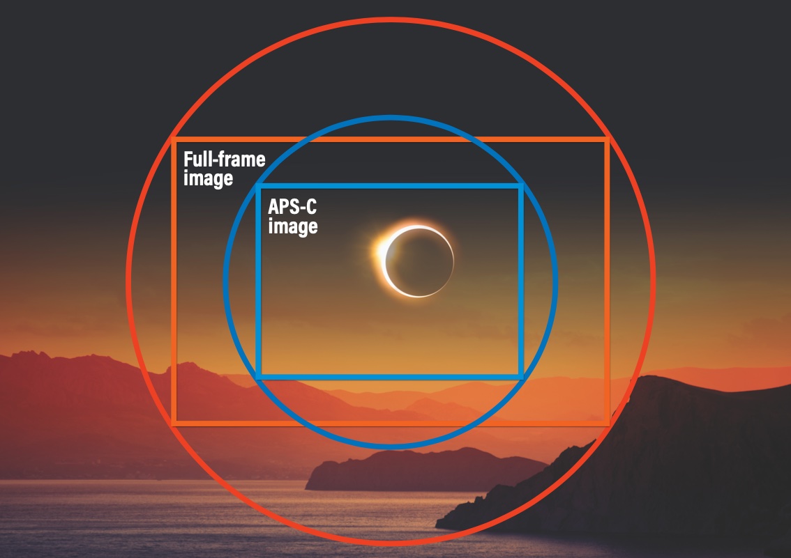

Not only do DSLRs and mirrorless cameras have larger sensors (or chips) than other cameras, they have two different chip options.
The first is a full-frame sensor. Professional photographers demand these because they capture a wider scene and collect more light than smaller sensors, producing a higher signal-to-noise ratio and improving the overall quality. Nighttime astrophotographers treasure this feature because it means they can shoot at high ISO numbers — which can lighten or darken the image — without introducing noise to the image.
The second type of sensor is the Advanced Photo System type-C (APS-C) sensor, which has an image aspect ratio of 3:2. This chip measures 1 inch by 0.7 inch (25.1 millimeters by 16.7 millimeters). Compared to a full-frame chip, an APS-C sensor crops the image so the subject occupies more of the frame, resulting in a narrower view. The difference changes the effective focal ratio of a lens by a factor of around 1.6.
Another big difference is that full-frame models (and mirrorless cameras, in general) are more expensive. In the case of photographing eclipses, you’ll be concentrating on the Sun, which is a ½°-wide circle of sky, plus the corona, which may extend 2° or 3° across. Spending $2,000 for a full-frame-chip camera is unnecessary when a $500 model will do.
At the end of the day, cameras with APS-C sensors produce top-of-the-line images of eclipses, and may be best for both your budget and your broader use.
