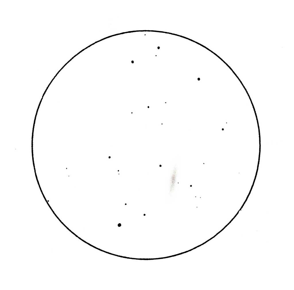

The author observed through a 16-inch f/4.5 Newtonian reflector at 150x to make this sketch of NGC 6690 in Draco. She used a circular observing template on white paper, a #2 graphite pencil, a felt-tipped superfine Faber-Castell Pitt artist pen, a 0.5mm mechanical pencil, and a blending stump. // Erika Rix

NGC 6690
For a challenge, swing over to NGC 6690 in Draco. This little 3.8′ by 1.3′ treasure (also known as NGC 6689 because of a catalog error) is a faint edge-on barred spiral galaxy with a surface brightness of magnitude 13.7. It lies 1.5° southeast of magnitude 4.2 Phi (ϕ) Draconis, between a 12th-magnitude star to the north-northeast and a magnitude 12.5 star to the southwest. A 13th-magnitude star stands just off its western edge.
Through a 10-inch scope, it appears faint and elongated to the north-northwest and south-southeast with a brighter center along its axis. It becomes mottled with diffuse ends at the northern and southern tips through a 16-inch telescope at 150x.
