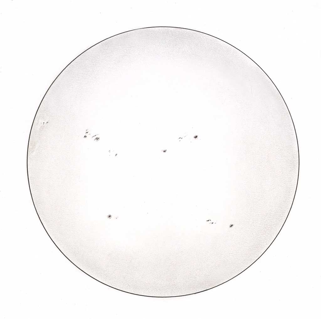

Viewing through a white-light (visual) filter makes a fine introduction to solar astronomy. It lets us observe the Sun’s gaseous photosphere, commonly referred to as its “surface,” and several of its features.
Sunspots, for example, show up well against the stark solar disk, becoming increasingly detailed at higher magnifications. They consist of umbrae, dark areas where the Sun’s magnetic field is strongest, and they may include filamentary penumbrae, the not-quite-as-dark regions surrounding umbrae. Sunspots are cooler than their surroundings, causing them to appear dark by comparison.

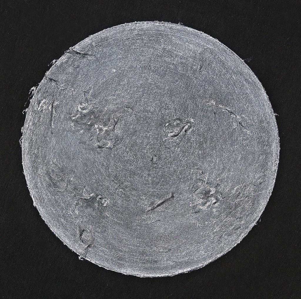

This Sun sketch shows features invisible through a white-light filter. The author observed with a 2.4-inch Hydrogen-alpha solar telescope with a double-stacked filter that yielded a bandpass of 0.45 angstroms and a magnification of 50x. She used a 6-inch drawn solar disk on black Strathmore Artagain paper, a white Conte crayon and pencil, a black oil pencil, and a charcoal pencil. The author rotated and flipped both sketches so that north is up and the preceding limb is to the right. // Both images: Erika Rix

Our second option, narrowband Hydrogen-alpha (Hα) filters, lets us observe the Sun’s chromosphere, the layer just above our star’s visible surface. Amateur astronomers use Hα filters that center on the red spectral line at 656.28 nanometers and let little else through.
Through this filter, the chromosphere is so alive with detail that sunspots lack the well-defined edges visible through a white-light filter. You will notice bright patches called “plage areas” — strong magnetic fields associated with faculae from the photosphere.

The author made this solar sketch through a 4-inch refractor with a white-light filter. The magnification was 83x. She used a 6-inch drawn disk on white card stock, a felt-tipped black artist pen, a charcoal pencil, and a No. 2 pencil.
You also will spot prominences. These large gaseous features extend outward from the Sun’s limb. When you spot a prominence silhouetted against the solar disk, it appears dark because the gas is cooler. Astronomers call those features “filaments.” Solar flares, which are less common, appear suddenly bright and last up to a few hours.

When you sketch the Sun in Hα, maintaining dark adaption is essential — and it isn’t easy in daylight. Blocking outside light around the eyepiece with a shield or dark cloth will improve your view and let you see faint detail that otherwise would be lost. Try sketching on black paper with a white pencil. This technique reduces glare, permitting your eyes to adapt more quickly when going from sketch to eyepiece.
