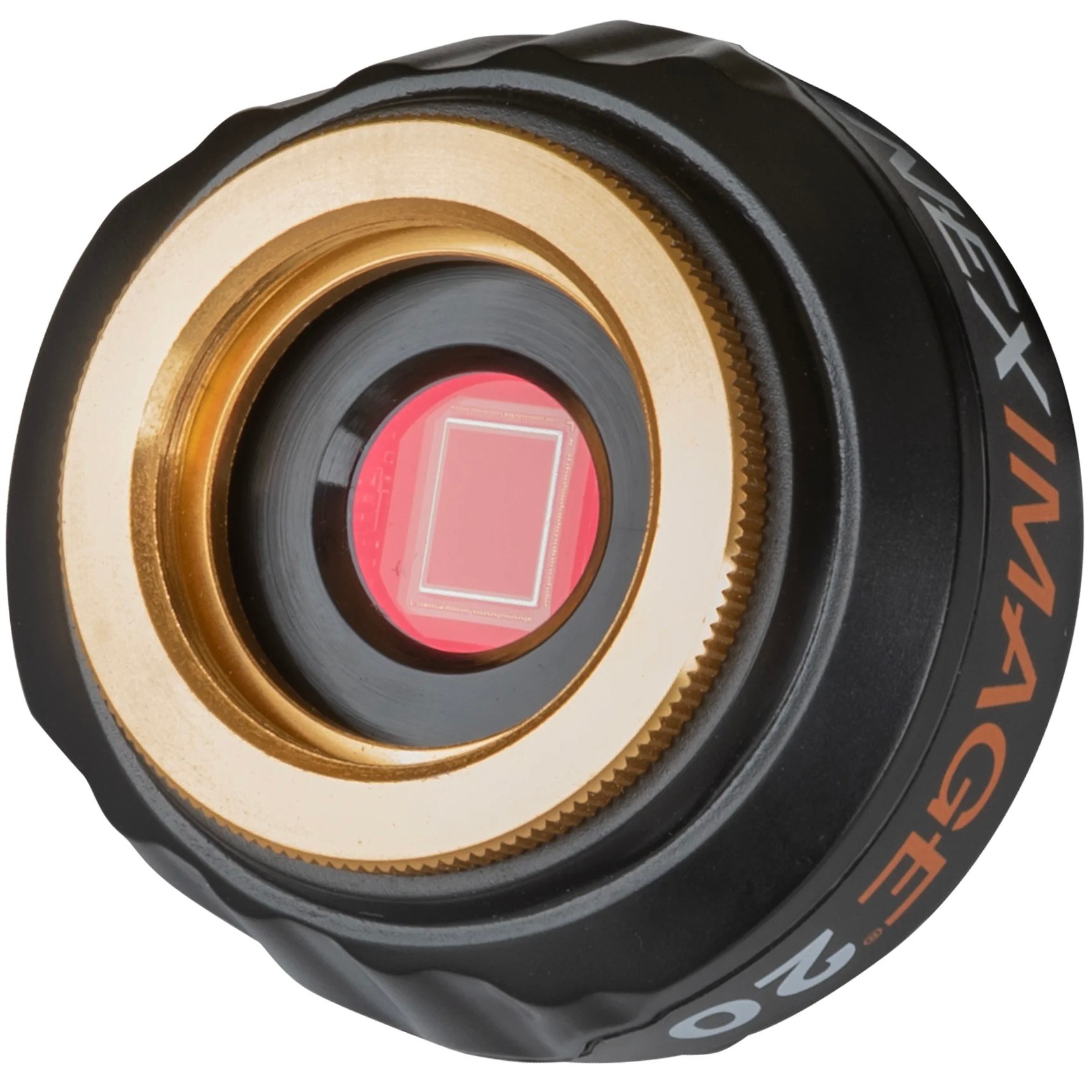

Built around an Onsemi AR2020 20-megapixel CMOS sensor, the NexImage 20 is, at its heart, a small USB camera optimized for close-up work on the Moon, planets, and the Sun.
Physically, the NexImage’s sensor is housed in a compact ABS plastic body measuring only 1.87 inches (4.8 centimeters) in diameter and weighing just 2 ounces (57 grams) with an aluminum connection ring and an optical window that includes a built-in IR-cut filter. The filter helps to produce sharp, true-color images.
The camera ships with a 1¼” nosepiece that threads onto the camera via a connection ring. It also includes a 10-foot (3 meters) USB-A-to-USB-C cable for powering the camera directly from the computer. That means you don’t need to add a separate power supply to the list of equipment you need to bring outside.
The NexImage 20’s high-speed USB 3.0 connection delivers maximum frame rates with minimal latency. This combination of fast data transfer, a sensitive modern sensor, and small pixels designed to capture fine detail places the camera among today’s leading solar system imagers. Its straightforward mechanical interface also makes it easy to use, whether you simply slide it into a 1¼” focuser or attach it by C-thread for a more permanent setup.
The NexImage 20’s sensor measures about 7.3 by 5.4 millimeters and delivers a 5240×3840 active-pixel array for 20-megapixel resolution. Each 1.4-micrometer pixel enables extremely fine sampling at long focal lengths, ideal for capturing subtle details under steady seeing. Its back-illuminated design boosts sensitivity, revealing faint cloud bands on Jupiter and delicate lunar shading.
