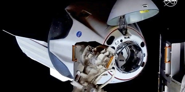

Crew Dragon, carrying two astronauts, docks with the International Space Station.
