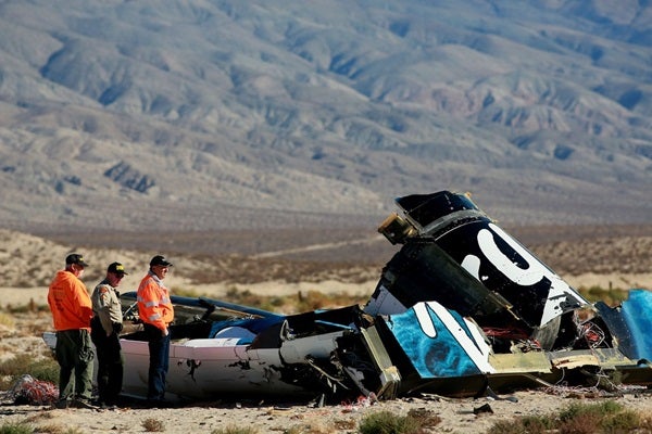

NTSB investigators are seen making their initial inspection of debris from the Virgin Galactic SpaceShipTwo. The debris field is over a five mile range in the Mojave Desert.

In a press conference at the Mojave Air and Sport Port on Sunday evening, acting NTSB Chairman Christopher Hart revealed preliminary findings in the investigation of the  Virgin Galactic SpaceShipTwo test flight accident that occurred October 31. According to Hart, review of cockpit video during the flight showed that the co-pilot Michael Alsbury turned the tail feathering lock-unlock lever to the unlocked position too early. But Hart was quick to add that the NTSB has not concluded that this represents a cause and effect, and more analysis is necessary.
“I am not stating this was the cause of this mishap,” he said. “We have months and months of investigation to determine what the cause was.”
Feathering of the tail is an action taken during reentry at high altitude in order to increase drag and accelerate the space vehicle’s descent. The apparently unscripted action by Alsbury was taken just seconds into the flight of SpaceShipTwo when the suborbital space vehicle had reached the speed of sound, Mach 1 in the denser atmosphere at roughly 50,000 feet. However, unlocking the feathering mechanism was not followed by the second step — moving of another lever which actually rotates the twin tail sections relative to the fuselage to increase the drag for the feathering, which is like a shuttlecock effect. Two seconds after Alsbury’s action and the feathering, SpaceShipTwo experienced a catastrophic breakup.
Feathering of the twin tail section of SpaceShiptTwo requires the pilots to execute two steps. The co-pilot Alsbury executed the first step — unlocking. According to the NTSB investigators, the unlocking of the mechanism should not have been enough to cause the feathering during the ill-fated test flight. The lock-unlock mechanism represents a safety feature. The feathering should only occur after the pilot moves a second lever which is not unlike the lever in a conventional aircraft that lowers the landing flaps to increase lift, but as with feathering, at the expense of adding more drag.

The SpaceShipTwo test flight accident occurred at 10:12 a.m. PDT on October 31. One day later, NTSB agents had arrived in the Mojave Desert to begin the investigation. During the first press conference, Hart stated that while the investigation is expected to last most of a year, he emphasized that the telemetry recorded during the flight was comprehensive and would be instrumental to uncovering a cause and effect.
The telemetry included several video recordings from the carrier aircraft WhiteKnightTwo, from ground video cameras, and also from inside the cockpit. It is a review of the latter that showed the releasing of the feathering safety lock mechanism by Alsbury. Co-pilot Alsbury died as a result of vehicle’s breakup while the pilot, Peter Siebold, escaped or was thrown from the vehicle and parachuted to the ground. Siebold is in serious condition but conscious and speaking to family and attending physicians.
