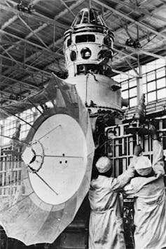

The spacecraft comprised a delivery “bus” about 11.5 feet (3.5 meters) tall, with a propulsion system, solar panels and a mesh dish antenna at one end, and the spherical landing craft at the other end. The landers had their own refrigeration system to cool them down and a heat shield to protect them. If all went to plan, the buses would eject the landers from orbit. The landers would hit the upper cloud decks at a speed of nearly 7.5 miles per second (12 kilometers per second).
At 60km altitude, the main parachute was released to float the lander down to the surface. A range of instruments would then measure the temperature, pressure, wind speed, visibility, atmospheric gases and rock composition, and radio the results back to Earth. Each lander carried a USSR medallion inside.
