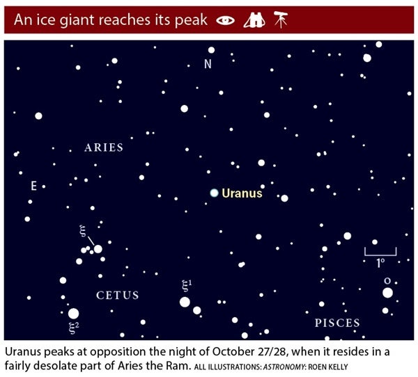

Uranus lies opposite the Sun in our sky the night of October 27/28. At opposition, the planet rises around sunset and sets near sunrise, so it remains a tempting object all night. Opposition also brings Uranus closest to Earth, so it shines brightest and looms largest when viewed through a telescope. Still, Uranus changes appearance slowly — it remains at magnitude 5.7 and its disk spans 3.7″ all month.
The ice giant glows brightly enough to spot with the naked eye from a dark viewing site. The key is knowing precisely where to look. Unfortunately, the faint background stars of southern Aries the Ram don’t offer much help, so it’s best to start with binoculars.
Uranus resides along a line connecting Aries’ brightest star, magnitude 2.0 Hamal (Alpha [α] Arietis), with magnitude 3.8 Alpha Piscium in neighboring Pisces. The two stars lie 21° apart, and the planet appears 1° closer to Alpha Psc. Don’t confuse Uranus with the similarly bright star 19 Ari, which stands 3° north and slightly east of the planet. Once you find the ice giant with binoculars, try to see it without optical aid.
A telescope delivers splendid views of Uranus because it lies high in the sky. From 40° north latitude on opposition night, the planet climbs 63° above the southern horizon at its peak shortly before 1 a.m. local daylight time. This is the highest it has appeared at opposition since February 1962. Even small scopes show the planet’s modest disk and distinctive blue-green color. For more on viewing Uranus and Neptune this autumn, see “Observe the ice giants” on page 52.

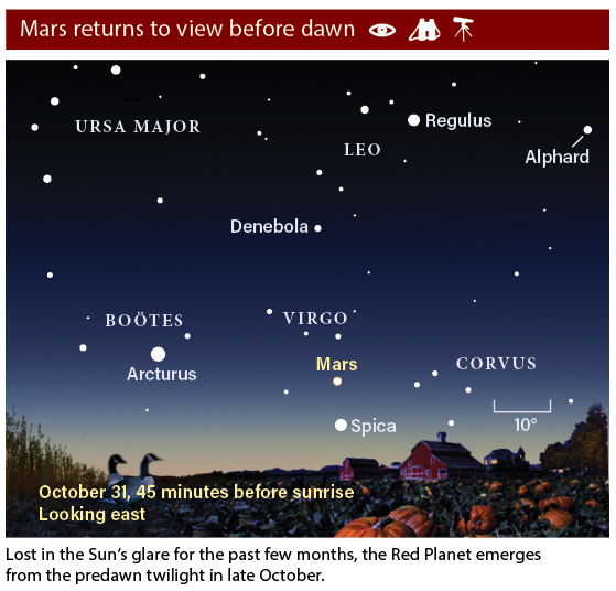

After a three-month hiatus, Mars returns to view before dawn in late October. On the 31st, it appears 7° high in the east an hour before sunrise. Shining at magnitude 1.8, the Red Planet should be obvious to the naked eye among the background stars of Virgo the Maiden. This marks the start of an excellent apparition for Mars, which will peak at opposition a year from now.

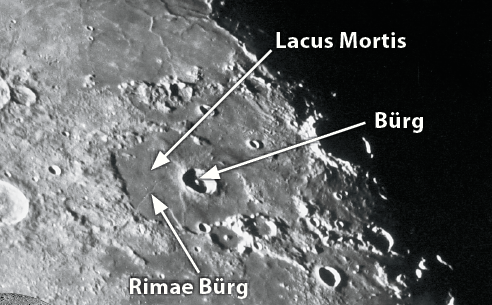

The best time to meet Lacus Mortis is during the late evening hours of October 17, when the lunar night is just about to swallow this lake and the prominent crater Bürg near its center for two weeks. Although most people observe the Moon when it is waxing, October’s earlier sunsets and longer nights allow us to view the waning gibbous Moon conveniently. Shining from the west instead of the east, the low Sun literally puts the terrain in a different light.
The lengths of shadows provide our eye-brain combination with cues to judge the heights of lunar features. Although little remains of Lacus Mortis’ eastern wall, the rather jumbled block of higher ground to the west (on the sunward side) casts a nice shadow. The rough texture comes from ejecta sprayed out from many previous impacts that overlay one another. Lava later welled up through the floor of Lacus Mortis and provided a clean slate for future hits.
Bürg Crater is much younger and sports a well-defined rim with a single central peak. At 25 miles across, it is big enough that its inner walls slumped down to form a relatively simple terrace. The two similarly sized craters on Lacus Mortis’ south rim show signs of more advanced age: Long-term bombardment has battered and softened their rims.
After rigor mortis froze the Lake of Death’s lava plain, the Moon continued to heave and subside underneath, leaving a fascinating set of fractures. The most prominent of these, Rimae Bürg on the lake’s southwestern side, is a rille (channel) formed when the terrain pulled apart. The scarp (cliff) to the south developed as the ground to its west collapsed. Another rille lies immediately east of this scarp. And if you head to the north, you’ll spot a wrinkle ridge created where the surface was pushed together.

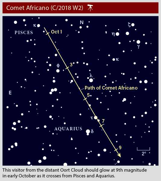

Comet Africano (C/2018 W2) peaked around 9th magnitude when it came closest to Earth on September 27, and it should maintain this brightness into early October. Although not a good target for suburban observers, it is ripe for viewing from dark-sky sites through a 4-inch telescope.
Once you home in on the comet, crank up the power as much as the night and your scope will allow to get a close-up view. In early October, its fan-shaped dust tail tilts nearly edge-on, so it looks like a narrow slice of pizza instead of a formless round blob. Its southern edge should appear concentrated and contain a nearly pointlike false nucleus. Imagers likely can capture a greenish or bluish glow on the comet’s eastern flank where sunlight ionizes escaping gas.
Astronomers Brian Africano and Hannes Groeller first spotted this comet within minutes of each other November 27, 2018. During October’s first week, it passes from Pisces the Fish into Aquarius the Water-bearer. This region lies due south and about halfway to the zenith in late evening. You can find Africano 2° southwest of 5th-magnitude Kappa (κ) Piscium the evening of October 1 and the same distance northwest of 3rd-magnitude Delta (δ) Aquarii on the 7th.

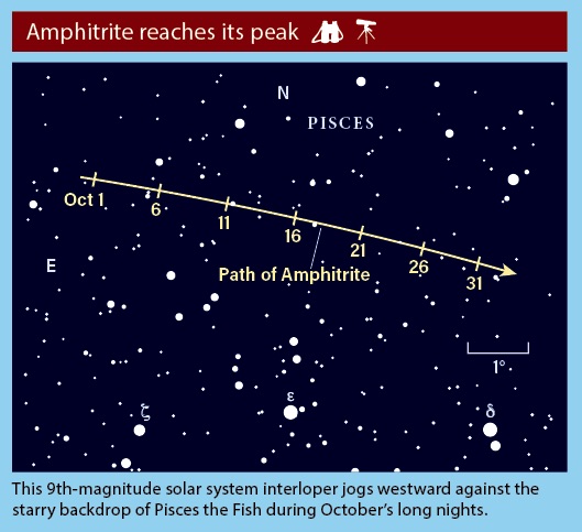

LOCATING ASTEROIDS: A rocky world traverses the celestial sea

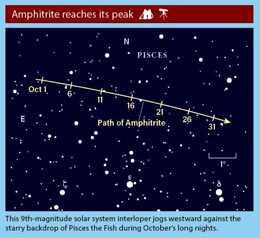

Asteroid 29 Amphitrite takes center stage in October. This main-belt object reaches opposition and peak visibility on the 13th, when it glows at magnitude 8.7 among the background stars of Pisces the Fish. Although this region remains on view all night, the asteroid shows up best once it climbs two-thirds of the way to the zenith in the southern sky around midnight local daylight time.
It takes just minutes to find Amphitrite by star-hopping from the 4th-magnitude stars Delta (δ) and Epsilon (ε) Piscium. Unlike the uniformly rich star fields of the Milky Way, the sparser splattering of stars of different magnitudes in the Fish makes it easier to identify the asteroid. Several nights this month, Amphitrite forms a simple pattern with background stars. A quick sketch of the area containing four or five objects will make it easy to see the asteroid’s movement from night to night.
German astronomer Albert Marth first detected this wanderer from a private London observatory in 1854. Although this was his only asteroid discovery, keen deep-sky observers should recognize his name from the faint NGC galaxies he discovered and his skill at logging precise positions for many more.
