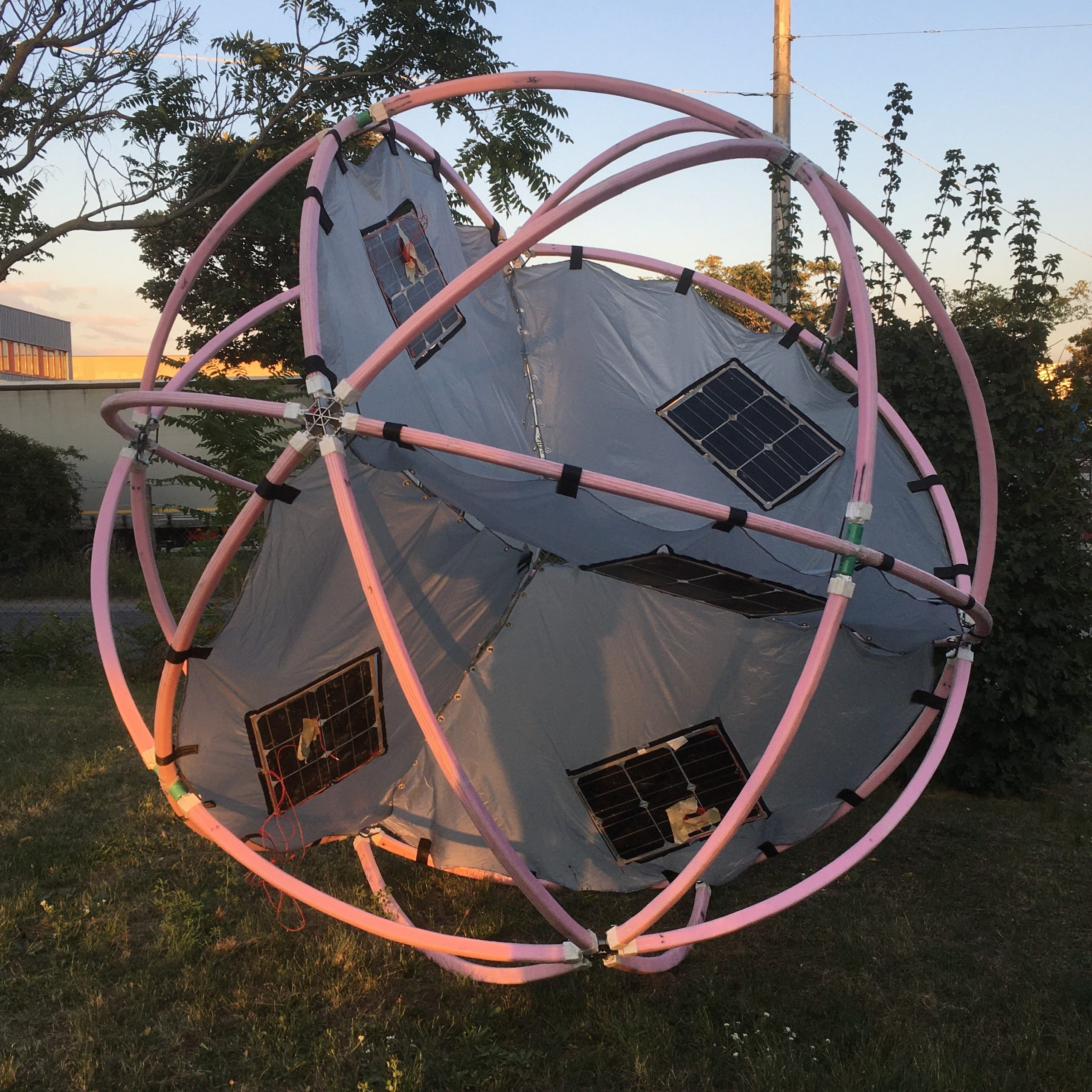

The Tumbleweed rover is a 16.4-foot-diameter (5 meters) sphere, utilizing six tetrahedrally arranged sails. These sails host solar cells to power the onboard electronics and recharge batteries for nighttime operation. To accommodate transport, the massive rovers can be collapsed into discs, reducing the payload space required on a rocket and helping them decelerate in their descent toward the martian surface as they unfold midair after being deployed.

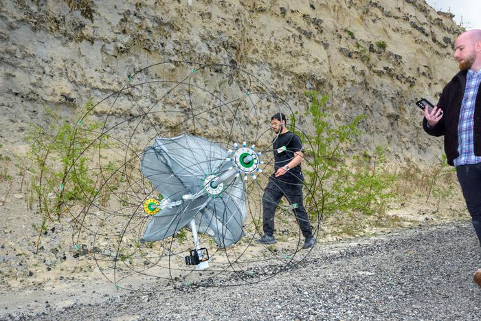

The Tumbleweed Science Testbed was field-tested in a quarry in Maastricht in April 2025. Credit: Team Tumbleweed/Sas Schilten
To move the technology from laboratory proof-of-concept to a flight-ready platform, Team Tumbleweed recently executed two critical testing phases. In a field test in Maastricht, Netherlands, a 8.8-foot-diameter (2.7 m) Tumbleweed Science Testbed prototype successfully collected and processed data using off-the-shelf sensors while actively tumbling over natural, uneven terrain.

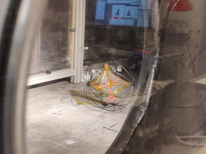

The most recent testing took place at Aarhus University’s Planetary Environment Facility. Scaled prototypes measuring 11.8, 15.7, and 19.7 inches (30, 40, and 50 centimeters) in diameter were subjected to static and dynamic tests in a wind tunnel replicating Mars-like conditions, including a low atmospheric pressure of 17 millibars. Results presented at the EPSC-DPS 2025 meeting confirmed that wind speeds of just 9 to 10 meters per second (or 32.4 to 36 km/h [20 to 22 mph]) were sufficient to set the rover in motion across various Mars-like surfaces, including sand, pebbles, and rough regolith. Furthermore, the prototypes demonstrated the ability to climb slopes equivalent to approximately 30 degrees on the martian surface.
