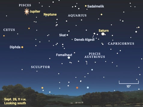

Moving right along
Jupiter first entered Pisces in mid-April; then, from late June until early September, it crossed in front of some stars in the northwestern corner of the constellation Cetus the Whale before returning to Pisces. This whole region lacks any bright stars, so it will provide a huge contrast to Jupiter’s brilliance. In fact, the nearest 1st-magnitude star, Fomalhaut (Alpha [α] Piscis Austrini), lies nearly 35° away.
For amateur astronomers in mid-northern latitudes, the planet’s location in Pisces means it will climb around halfway up the sky — not terrible, but still some distance from where you’d get the best views. For anyone at latitude 40° north on the date of opposition, Jupiter’s altitude at local midnight will be 50° above the southern horizon. In the Northern Hemisphere, for each degree of latitude south of 40° north an observer is, Jupiter will appear 1° higher; for each degree north of 40°, it will be 1° lower.

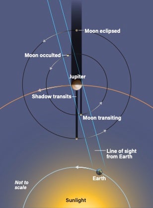

The ever-changing configuration of these moons can lead to four different types of observational events.
An eclipse occurs when a satellite moves through Jupiter’s shadow, but is not positioned behind the planet from our point of view.
An occultation happens when a satellite passes behind Jupiter. These events occur along the planet’s limb (edge). Eclipse events are easier to observe than occultations because eclipses usually take place some distance from Jupiter’s limb. Moons always disappear into occultation at the west side of Jupiter and reappear at the planet’s east side.
A transit occurs when a moon moves in front of the planet. A transiting satellite always moves from east to west across Jupiter’s face. The satellites themselves look like bright dots against Jupiter’s dark belts. When a satellite lies in front of the brighter zones, however, it’s hard to see unless you follow it from the time the transit starts.
A shadow transit happens when a moon’s shadow moves across Jupiter’s disk. Shadows of the moons look like small black dots on Jupiter through any telescope. Transiting shadows also move from east to west across Jupiter.
Before opposition, from our perspective on Earth, Jupiter’s shadow extends west of the planet, so a satellite will be eclipsed before it’s occulted. The satellite being eclipsed gradually fades as it enters Jupiter’s shadow, which is pretty cool to watch.
The two outer satellites, Ganymede and Callisto, are usually far enough from Jupiter to reappear from an eclipse, so you’ll be able to see them disappear into occultation. However, Io and Europa emerge from their eclipses after their occultations start, so you won’t see them reappear — they’ll be behind the planet.
After opposition, when Jupiter’s shadow falls east of the planet, occultations occur before eclipses. Then, you’ll be able to see Io and Europa disappear into occultation and reappear from eclipse.
For transits and shadow transits before opposition, the satellite’s shadow falls on the planet before the transit starts. After opposition, this order is reversed: The satellite begins its transit and the shadow follows.
Please note that any of these events can occur simultaneously among the four moons. For example, you might observe one or more satellites in transit across Jupiter, concurrent shadow transits, or multiple moons occulted by the planet.
If you have a 10-inch or larger scope and a night with great sky conditions, look for details on the moons. With high magnification (above 350x), you’ll resolve their disks, especially during transits when the moons’ glare drops because Jupiter’s lit background provides less of a contrast than the black sky. Zoom in on Ganymede, the largest moon, first. Look for light-colored ice near its poles. Through bigger scopes, you might be able to see each satellite’s (extremely) subtle color.
JK2
In this diagram, Jupiter has not yet reached opposition, and the planet’s shadow extends off to the west (right) as seen from Earth. Observers would be able to see the outer moon be eclipsed, emerge from eclipse, and then be occulted. However, the inner moon will be occulted before it emerges from eclipse. A moon and its shadow can transit the planet, though not necessarily at the same time.
Astronomy: Roen Kelly

As summer transforms to fall in the Northern Hemisphere, Jupiter provides a brilliant target for any observer, no matter your equipment. It’s so bright, in fact, that you won’t need to head to a dark site to view it. Set your scope up in your yard, pull up a chair, and carve out some time to see the giant planet at its best.
JK4
Jupiter reaches opposition Sept. 26 but will dominate its region of the sky for months. It spends the last half of 2022 in Pisces and Cetus, an area devoid of bright stars.
