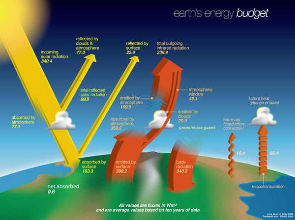

On average, the planet receives 340.4 watts of sunshine per square meter. All sunshine falls on the daytime side, and the numbers are much higher at local noon.
Of that 340.4 watts per square meter:
- 99.9 watts are reflected back into space by clouds, dust, snow and the Earth’s surface.
- The remaining 240.5 watts are absorbed – about a quarter by the atmosphere and the rest by the surface of the planet. This radiation is transformed into thermal energy within the Earth system.
Almost all of the absorbed energy is matched by energy emitted back into space. However, a residual now accumulates as global warming. That residual has increased, from just under 0.6 watts per square meter at the end of the last century to 0.79 in 2006-2018, according to the latest data from the Intergovernmental Panel on Climate Change. The vast majority of that is now heating the oceans. While it might sound like a small number, that energy adds up.
The atmosphere absorbs a lot of energy and emits it as radiation both into space and back down to the planet’s surface. In fact, Earth’s surface gets almost twice as much radiation from the atmosphere as it does from direct sunshine. That’s primarily because the Sun heats the surface only during the day, while the warm atmosphere is up there 24/7.
Together, the energy reaching Earth’s surface from the Sun and from the atmosphere is about 504 watts per square meter. Earth’s surface emits about 79% of that back out. The remaining surface energy goes into evaporating water and warming the air, oceans and land.
The residual between incoming sunshine and outgoing infrared is due to the accumulation of greenhouse gases like carbon dioxide in the air. These gases are transparent to sunlight but opaque to infrared rays – they absorb and emit a lot of infrared rays back down.
Earth’s surface temperature must increase in response until the balance between incoming and outgoing radiation is restored.
