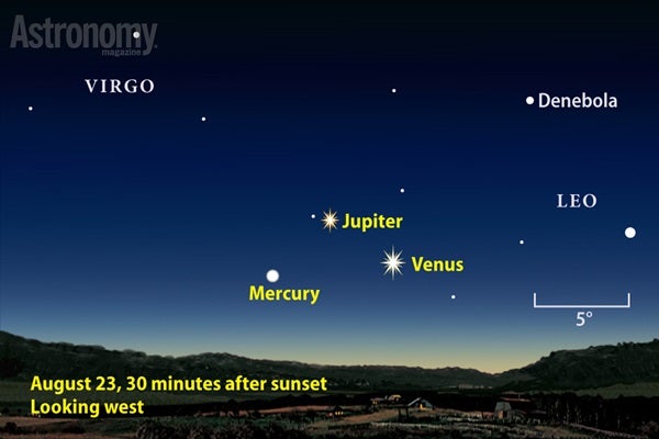

Mercury then starts to head back toward the Sun while Venus and Jupiter, which lie 11° apart on the 16th, continue to close in on each other. The three planets form an elegant triangle that changes shape each evening. Perhaps the ­prettiest scene occurs on August 23, when Jupiter stands 4° from both Mercury and Venus and the two inner planets appear 6° apart.
Jupiter, Venus, Mercury
Mercury, Venus, and Jupiter form a pretty isosceles triangle August 23. Four days later, Venus slides within 0.1° of Jupiter.

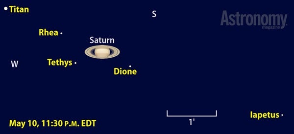

Saturn’s moons offer a similar range of observing challenges. The brightest moon, 8th-magnitude Titan, is an easy object through any telescope. It circles the planet once every 16 days, passing due north of Saturn on August 8 and 24 and due south on August 15 and 31. Between those times, Titan can stray up to 2.8′ from the planet.
Several smaller moons orbit Saturn in five days or less and remain within 1′ of the ring’s outer edge. The three brightest — Tethys, Dione, and Rhea — all shine at 10th magnitude and show up through 4-inch scopes on clear nights.

More challenging are 12th-magnitude Enceladus and 13th-magnitude Mimas. The former revolves around Saturn in 33 hours and the latter in just 23 hours. Each circles the planet just beyond the edge of the rings, whose brightness typically masks them. You’ll need a 6-inch or larger instrument with good optics to pull them in, and then only when they lie near greatest elongation. Give it a try the evening of August 8, when they reach greatest eastern elongation within 10 minutes of each other.
Distant Iapetus takes 79 days to complete a circuit of Saturn. With such an extended orbit, this moon rarely appears close to the planet. Your best bet for seeing it comes August 18, when it glows at 11th magnitude and lies 2.1′ due south of Saturn. The satellite then heads west and brightens slowly as its brighter hemisphere turns toward Earth. On August’s final night, it shines near 10th magnitude some 7′ from the planet.

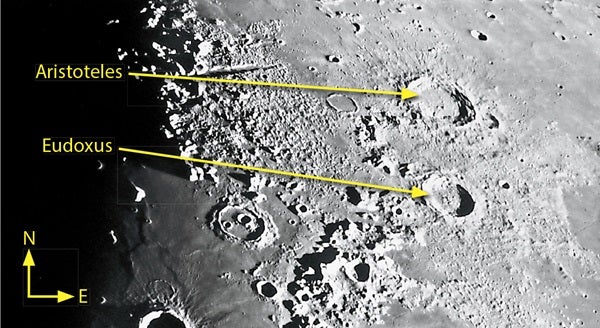

A couple of days before First Quarter phase, the Moon shows us a face of thirds. The south is a crowded, cratered mess that quickly morphs into the slate-gray maria that dominate the equatorial regions. A look at Luna’s northern third reveals an overall smoothness punctuated by a handful of large, identifiable craters.
On August 8, the rising Sun sets the ramparts of Aristoteles aglow even while the crater itself lies on the dark side of the terminator that divides day from night. One Earth day later, this marvelous crater appears fully lit except for a small shadowed zone tucked against its eastern wall, corresponding to the photo at right. Craters half its 55-mile diameter boast cleaner lines and a simpler peak, but Aristoteles’ features suffered more from the greater energy release of a large impact. In moments of good seeing, a lot of structure pops into view.
The blast excavated plenty of soil, which splattered down to create the large debris apron around Aristoteles as well as a huge number of small secondary craters. You can see them flit in and out of view only in the slanted light near lunar sunrise or sunset. By August 11, the higher lunar Sun has erased all evidence from view. The inside of the crater’s walls, weakened from the impact, slumped into a series of terraces. Millions of years later, lava welled up from beneath and flooded the inside, but not quite enough to cover the central peaks.
Return for a quick look around the August 17/18 Full Moon. The dark gray Mare Frigoris sweeps in a gentle arc across the lunar north while Aristoteles has been transformed to an oval of light material paired with the smaller, more circular crater Eudoxus just to its south.

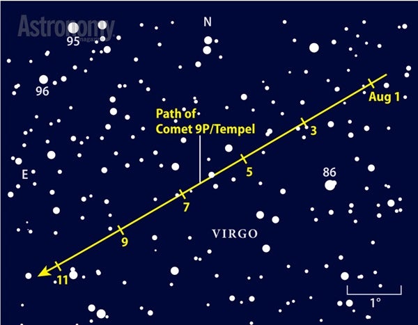

The hands of the celestial clock have aligned again for Comet 9P/Tempel. Eleven years and one month ago, thousands of amateur and professional astronomers locked their eyes and instruments onto this 4-mile-wide object, waiting with bated breath for a coffee-table-sized copper bullet carried by NASA’s Deep Impact probe to smack the nucleus. Two revolutions around the Sun later it has returned, mostly unharmed, to give us an 11th-magnitude fuzzball sailing eastward away from Spica.
It’s best to catch the comet during the first week of August before the Moon sheds too much light into the evening sky. For the same reason, try to get as far away from city lights as you can. Use the magnitude 5.5 star 86 Virginis, which lies 5° east of Spica, as your guide. Although a 4-inch telescope will show Tempel’s feeble glow, you’ll need an 8-inch scope to get a decent look.
The Deep Impact spacecraft revealed that the comet’s surface layer is mostly empty space — not the hard-packed ice-rock mixture that astronomers had expected. Another surprise: The water vapor and carbon dioxide spewing from the comet come out from different regions.

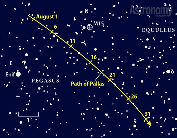

The first step in tracking down asteroid 2 Pallas is easy. Even from the suburbs, most people can readily find magnitude 2.4 Enif (Epsilon [ε] Pegasi). The bright star marks the nose of the Winged Horse and lies a bit west of that constellation’s Great Square. Pallas begins August 3° north-northwest of Enif and then heads southwest, passing between the star and the lovely globular cluster M15.
If you think of the Milky Way as a city, Pallas lies in the suburbs. The star density here is lower, so in principle it should be easier to find Pallas. But like the houses in some suburbs, the star fields in this vicinity can start to look alike. To find Pallas, carefully match the star patterns you see through your telescope with those on the finder chart below. To be sure you’ve pegged the asteroid, sketch the field where you think it is and then come back to it a night or two later. The object that has shifted position is Pallas.
The asteroid reaches opposition and peak visibility on August 20, when it shines at magnitude 9.2 and remains visible all night. Unfortunately, it now lies on the outer part of its elliptical orbit, so it appears about two magnitudes fainter than at a favorable opposition. German astronomer Heinrich Olbers discovered this main belt object in 1802.
