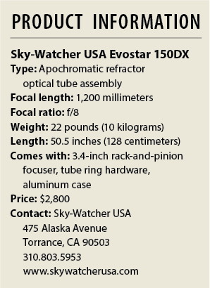

The flagship Evostar 150 comes in two different versions. Both are identical optically. The only differences are in some of the mechanics. The Evostar 150 comes with a Vixen-style dovetail plate and a 2″ focuser with a 1¼” adapter. The Evostar 150DX includes a dual-speed 3.4-inch rack-and-pinion focuser with 1¼” and 2″ adapters, rotatable tube rings, a Losmandy D-style dovetail plate, a 3.75″ extension tube, a Canon DSLR adapter, and dust caps. Although a finder doesn’t come with either model, you’ll find a standard shoe-style base mounted on the tube adjacent to the focuser. However, you’re on your own for eyepieces and a suitable mount.

The scope’s sturdiness was immediately apparent as I lifted it out of the heavy-duty, custom-fitted aluminum carrying case. The case’s exterior measures 553/8″ long by 15¼” wide by 11½” high (141 by 39 by 29 centimeters), and it has plenty of room inside for accessories.
The robustness of the case comes at a price, however: weight. The case alone weighs twice as much as the telescope. The Evostar 150DX with the rings and dovetail plate in place, but without a finder or eyepiece, weighs 24.8 pounds (11.2 kilograms). When the refractor is nestled in the case, the pair totals 61.6 pounds (27.9 kg). While that is manageable by one person — I did it — it’s best carried by two. There is a single carrying handle centered on the case, as well as one at either end. If you will be transporting the Evostar to a dark-sky site by yourself, a soft, padded case will be more practical. Leave the hard case at home for safe storage.
The tube assembly, with the dew shield threaded in place and the focuser racked all the way in, measures 49 inches (124 cm) long. Tube diameter is 7.1 inches (18 cm), while the dew shield is 8 inches (20 cm) across. Inside, three flat-black light baffles help suppress unwanted spurious light from spoiling the view.
The oversized focuser’s drawtube has 3.5 inches (8.9 cm) of back-focus travel. The focuser is rotatable, and Sky-Watcher USA marked the drawtube with graduations. Both features make it easier for photographers to view through camera viewfinders and repeat a focuser setting once established.
