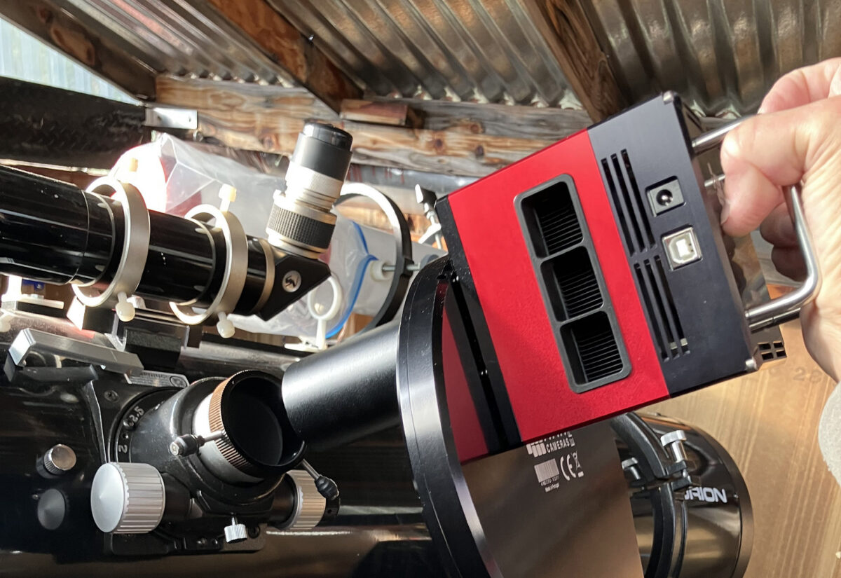

The author installs an Atik 16200 CCD (at the right of image) with the Nexus coma corrector (middle) attached into the focuser of his scope (at left) for imaging.

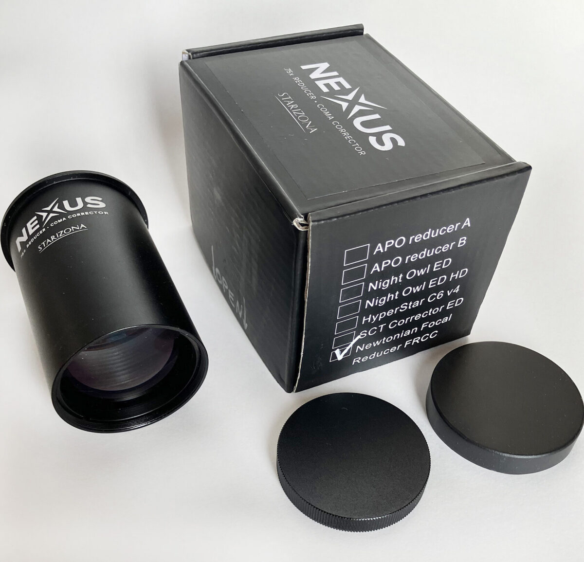

: The Nexus coma corrector (to the left of the box) comes with a metal cap for its 48mm threaded camera end and a plastic cap for the lens end. All parts are packaged in a custom, foam-lined box.

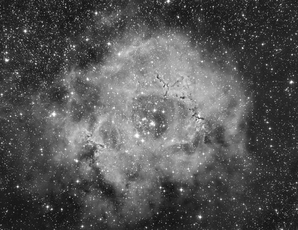

The Nexus not only corrects coma, it also increases field of view and telescope speed. This intricately detailed single frame of the Rosette Nebula, taken with the Nexus and Atik 16200 CCD on the author’s 10-inch scope, has an exposure time of only 5 minutes. The resulting field of view is more than 2°.

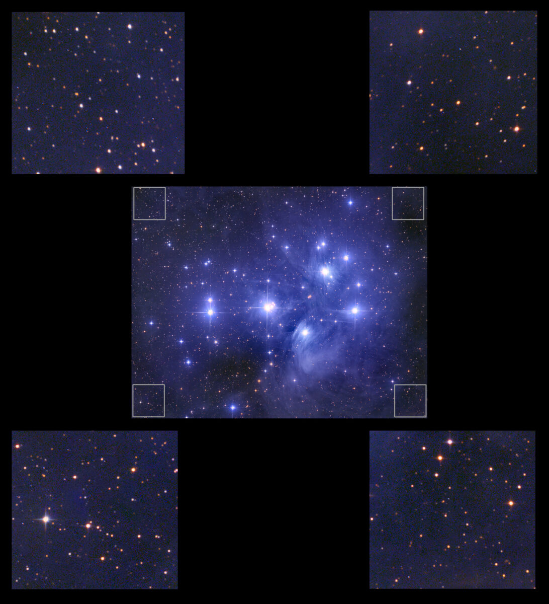

All four corners of this image of M45 show sharp stars, thanks to the incorporation of the Nexus coma corrector into the imaging assembly.
