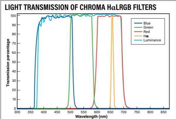

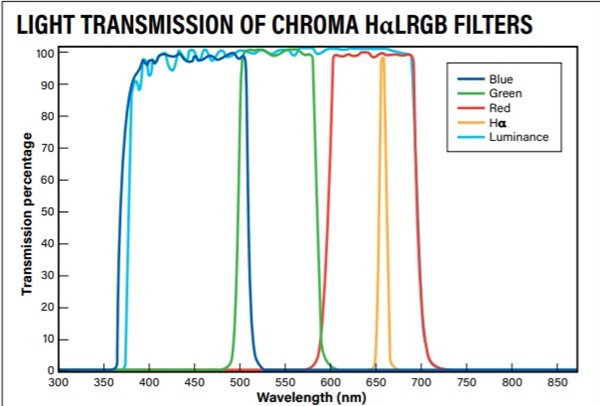

LIGHT TRANSMISSION OF CHROMA HαLRGB FILTERS
Chroma filters are not just durable, they are also meticulously designed to allow high transmission of only desired wavelengths of light, as seen in this spectral chart

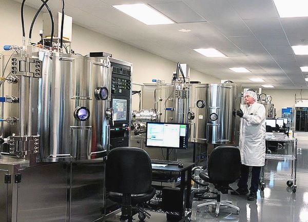

Chroma utilizes vacuum chambers,
To apply their hardy front coatings, Chroma utilizes vacuum chambers, like the one seen here. This, along with cutting the filters to their final shape after applying the coating, leads to an even layer of protection all the way out to the edge of the filter.
