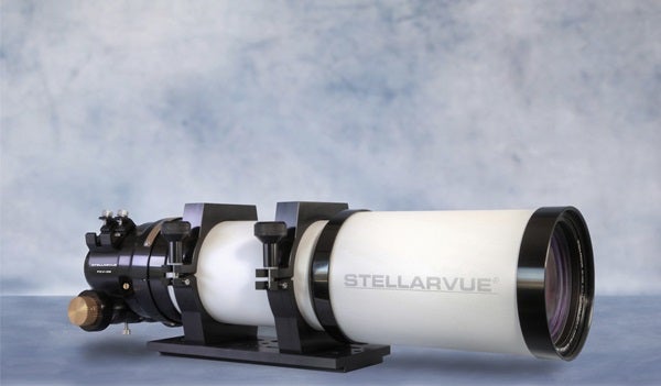

Scope2
Explore Scientific
Stellarvue SVX102D
Featuring an advanced 4-inch (102mm) objective lens, the SVX102D delivers incredibly sharp images. Be aware that you will need to purchase a mount and other accessories separately.
SPECIFICATIONS
  • Price: $2,195.00
  • Mount: altitude-azimuth or equatorial
  • Aperture: 4 inches (10.2 cm)
  • Focal length: 714mm
  • Focal ratio: f/7
  • Eyepieces: not included
  • Weight: 9 pounds (4.1 kg)

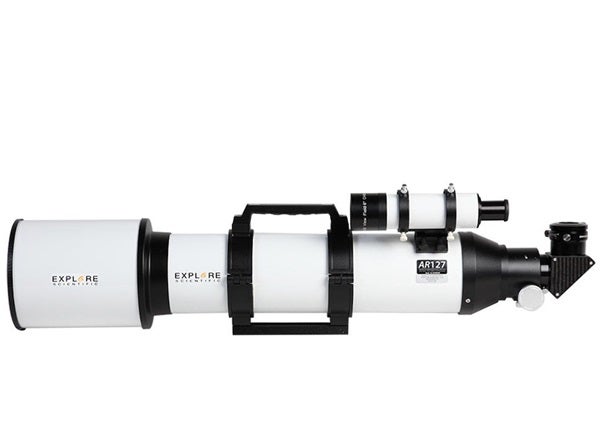

Scope3
Explore Scientific
Explore Scientific FirstLight AR127
Equipped with the Twilight I Mount, the AR127 features a 5-inch (12.7 cm) objective. Accessories include a 25mm eyepiece, a star diagonal, a red-dot finder, and a smartphone camera adapter.
SPECIFICATIONS
  • Price: $749.99
  • Aperture: 5 inches (12.7 cm)
  • Focal length: 826mm
  • Focal ratio: f/6.5
  • Weight: 15.6 pounds (7.1 kg)

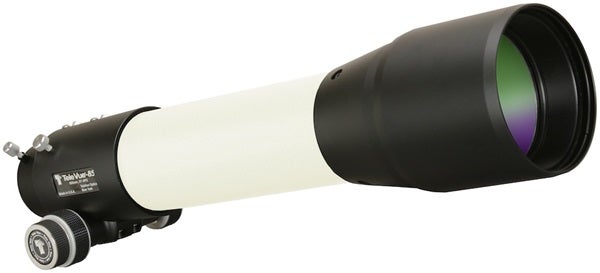

Scope4
Tele Vue
Tele Vue-85
For those looking for a grab-and-go telescope, the 3.35-inch (8.5 cm) TV85 is a great choice. Couple it to a sturdy mount (sold separately) and you have a wonderful scope for both astronomical and terrestrial viewing.
SPECIFICATIONS
  • Price: $2,167.00
  • Aperture: 3.35 inches (8.5 cm)
  • Focal length: 600mm
  • Focal ratio: f/7
  • Weight: 6.1 pounds (2.8 kg)

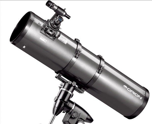

Scope6
Orion
Orion SkyView Pro 8
This 8-inch (20.3 cm) reflector mates a well-appointed Newtonian to a substantial German equatorial mount and tripod. Standard accessories include two eyepieces and an 8×40 finder scope.
SPECIFICATIONS
  • Price: $849.99
  • Mount: equatorial mount
  • Aperture: 8 inches (20.3 cm)
  • Focal length: 1000mm
  • Focal ratio: f/4.9
  • Eyepieces: 25mm (40x) and 10mm (100x)
  • Weight: 56.5 pounds (25.6 kg)

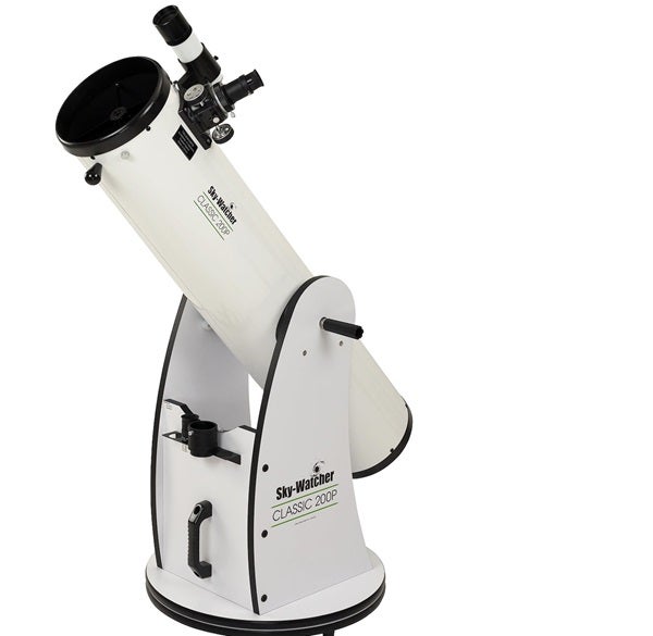

Scope7
Sky-Watcher
Sky-Watcher Classic 200P
This basic Dobsonian delivers a lot at an affordable price. The 8-inch (20 cm) primary mirror gathers enough starlight to reveal faint galaxies, clusters, and nebulae. The mount may be no-frills, but it is built to last for years. Two eyepieces, dust caps, and a finder scope are also included.
SPECIFICATIONS
  • Price: $655.00
  • Mount: Dobsonian
  • Aperture: 8 inches (20 cm)
  • Focal length:
    1200mm
  • Focal ratio: f/5.9
  • Eyepieces: 25mm (48x) and 10mm (120x)
  • Weight: 45 pounds (20.4 kg)

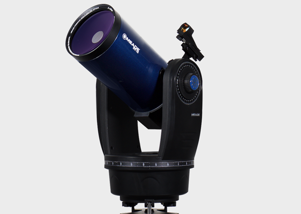

Scope9
Celestron
Meade ETX125 Observer Maksutov-Cassegrain
The ETX125 is perfect for aspiring astroimagers. Using the attached camera, one can look through an eyepiece, using the built-in star diagonal, and then quickly flip the mirror out of the way to take a photo.
SPECIFICATIONS
  • Price: $829.99
  • Mount: equatorial dual-fork
  • Focal length: 1900mm
  • Focal ratio: f/5
  • Eyepieces: 9.7mm (196x) and 26mm (73x)
  • Weight: 25 pounds (11 kg)

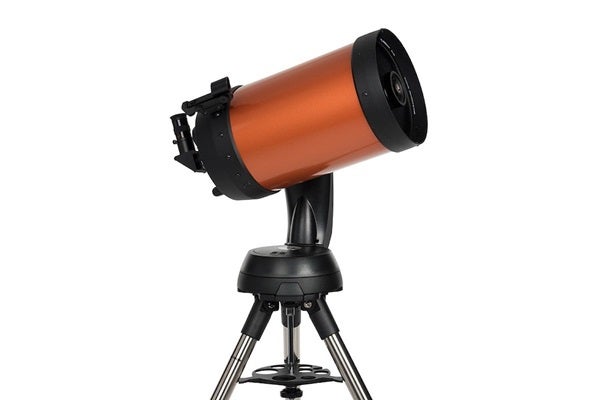

Scope10
Celestron
Celestron NexStar 8SE
The NexStar 8SE features the legendary Celestron 8 telescope on a one-armed, computer-controlled mount that automatically locates and tracks objects selected from the onboard database. It comes with a red-dot finder, a 25mm eyepiece, and a star diagonal.
SPECIFICATIONS
  • Price: $1,599.00
  • Focal length: 2032mm
  • Focal ratio: f/10
  • Eyepieces: 25mm (81x)
  •  Weight: 24 pounds (10.9 kg)
