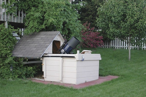

When it was operational, Everstar Observatory, nestled in a backyard in Olathe, Kansas, was a great example of a well-designed space in which to store a telescope.

Without a doubt, the best place to keep a telescope is in an observatory, which offers a controlled environment and easy access to the night sky. Of course, not everyone can build an observatory, nor is one always warranted or desired.
Closets in unheated garages and wooden toolsheds share many of the advantages of an observatory, although you may have to vent them to the outside so air can circulate. Metal, vinyl, or plastic sheds are not as good because such materials trap heat more than wooden enclosures.

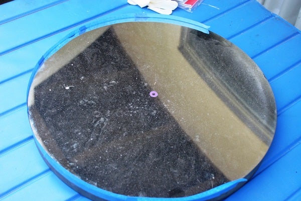

If the mirror in your reflector looks like this, cleaning it will enable it to gather more light. It will also scatter less of the light it collects and perform much better.

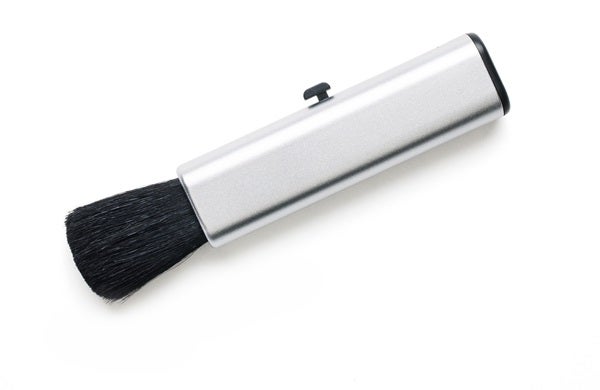

Begin the process by removing all particles that have found their way onto the surface. This does not mean blowing across the lens with your mouth; you’ll only spit all over it. Instead, use either a camel hair brush or a can of compressed air. Some brushes come with air bulbs that let you blow and sweep at the same time. If a brush is your choice, lightly whisk the surface of the lens in one direction only, flicking the brush free of any accumulated dust particles at the end of each stroke.
Many amateur astronomers prefer to use compressed air instead of a brush because nothing touches the surface. Hold the can upright with the nozzle away from the lens at least as far as recommended by the manufacturer. If the can is too close or tilted, some of the propellant could strike the glass surface and stain it. Also, best results come with several short spurts of air instead of one long gust.

A camel hair brush is the tool of choice for most amateur astronomers who wish to quickly eliminate visible particles on lenses or mirrors. Be sure to flick the brush clean after each stroke to prevent dragging anything across your optics. All product photos:

When you clean a mirror, take special care not to damage the fine optical surface. The mirror’s thin coating of aluminum is extremely soft, especially when compared to abrasive dirt, and you can gouge it easily.
Cleaning a telescope’s primary or secondary mirror typically requires you to remove it and the cell that holds it in place from the telescope. Consult your owner’s manual for specific instructions.
With the mirror lying on a table, use compressed air to begin the cleaning. Don’t use a brush for this step, to avoid any possibility of damage.
Next, inspect the mirror’s coating for pinholes and scratches. A good coating can last 10 years or longer if the mirror has been well cared for. To check it, hold the mirror, reflective side toward you, in front of a light. It’s not unusual to see a faint bluish image of the light through the mirror if the source is bright, but its image should appear the same across the entire mirror. If not, there may be thin, uneven spots in the coating.
Any scratches or pinholes in the coating will become immediately obvious, as well. You can live with a few, but if scratches or pinholes abound, or if you detect an uneven coating, you’ll want to send the mirror out for recoating.
If the coating is acceptable, bring the mirror to a sink. Be sure to clean the sink first and lay a folded towel in it as a cushion just in case the mirror slips. Gently run lukewarm tap water across the reflective surface. This should lift off any stubborn dirt particles that refused to dislodge themselves under the compressed air.
Next, fill the sink with enough tepid tap water to immerse the mirror and add to it a few drops of gentle liquid dish soap. Carefully lower the mirror into the soapy water and let it sit for a minute or two.
With a big, clean wad of surgical cotton, sweep across the mirror’s surface ever so gently with the backward rolling motion I described earlier, being careful not to bear down. Roll the cotton a half-turn backward, discard it, and use a new piece. If stains remain after this step, let the mirror soak in the water for five to 10 minutes and repeat the sweeping with more new cotton.
With the surface cleaned, drain the sink. Run tepid tap water on the mirror and its holder for a while to rinse away all soap. Then turn off the tap and pour room-temperature distilled water across the surface for a final rinse.
Finally, rest the mirror on a towel and let it dry. I usually rest it against a pillow on my bed. Tilt the mirror at a fairly steep angle (greater than 45°), its edge resting on the soft towel to let any remaining water droplets roll off without leaving spots. When it’s dry, insert it into the telescope, collimate the optics, and you’re done!
