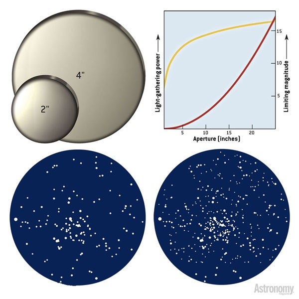

Consider the mirror size when buying a telescope.
4-inch-diameter mirror has four times the light-gathering area of a 2-inch-diameter mirror. A larger scope gathers more light, so you can observe fainter objects. The faintest star you can see through your telescope — “limiting magnitude” — depends on the size of the objective. A star field is shown above through a 2-inch (bottom left) and a 4-inch (bottom right).

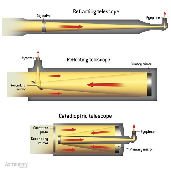

The three main types of telescopes use lenses, mirrors, or a combination of both.
Refracting telescopes use lenses — combining at least two, and as many as four, pieces of glass — as their objective (the primary light-gathering device).
Reflecting telescopes use mirrors to gather and focus light. In a Newtonian reflector — the most common type — light reflects from the primary mirror (whose surface is ground into a parabola so light comes to a common focus). The light strikes a smaller, flat secondary mirror near the top of the tube. The light then is bent 90° and enters the eyepiece through a small hole in the tube.
Catadioptric, or compound, telescopes incorporate a primary mirror coupled with a corrector lens placed at the front of the tube. The primary mirror’s curve is ground to a simple shape, usually a sphere. Ordinarily, a spherical mirror would introduce aberrations in the viewed image, but the corrector of a catadioptric scope “pre-bends” the light before it strikes the mirror. Two popular catadioptric telescopes are the Schmidt-Cassegrain and Maksutov-Cassegrain designs.

6. I’ve heard “bigger is better” is true when it comes to telescopes. What are the real advantages of big scopes?
The larger the telescope’s diameter, the more light it will collect. A 4-inch refractor, for example, is a great scope for planets, the Moon, and double stars. I know because I own one, and I wouldn’t part with it for love or money. This size scope, however, is a bit small for deep-sky objects such as nebulae, star clusters, and galaxies.
An 8-inch telescope (it doesn’t matter what type) will move you into a new dimension of viewing. The objects you see with an 8-inch scope will reveal more detail. Keep in mind, however, that if you stay interested in observing, you’ll crave even larger scopes. This malady among amateur astronomers is known as “aperture fever.” And, yes, I’m infected. I started many years ago with a 2.4-inch telescope of good quality. I now own a 4-inch refractor and an 8-inch Schmidt-Cassegrain. Am I happy? Yes. Am I satisfied? Not even close. I now dream of a 20-inch telescope. I think you get the idea.

3 types of telescopes
