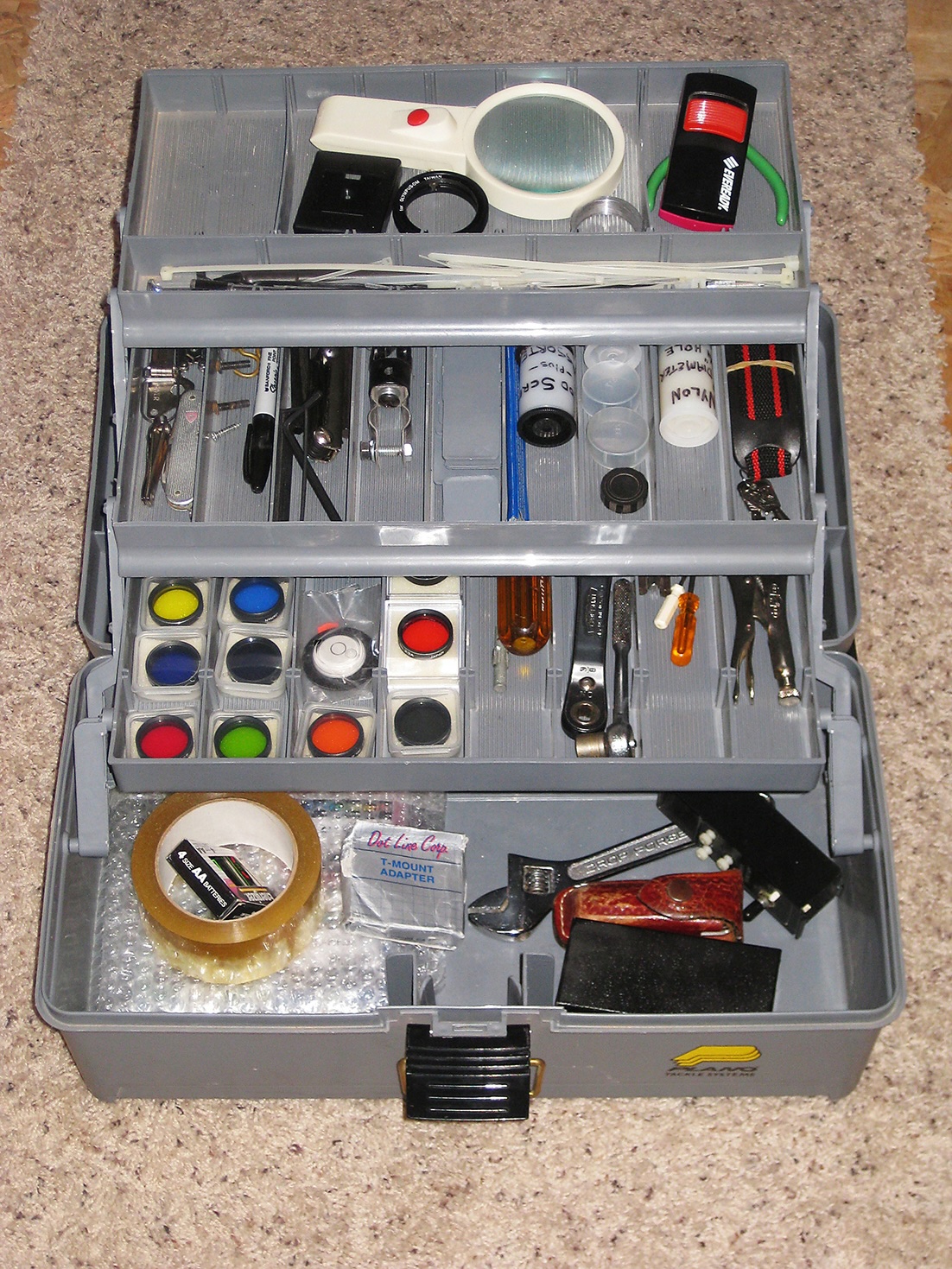

Your observing kit should contain everything you need for each session. This kit, housed in a large fishing tacklebox, has enough space even for items only needed occasionally. Eyepieces are in a separate padded case. Credit: Michael E. Bakich

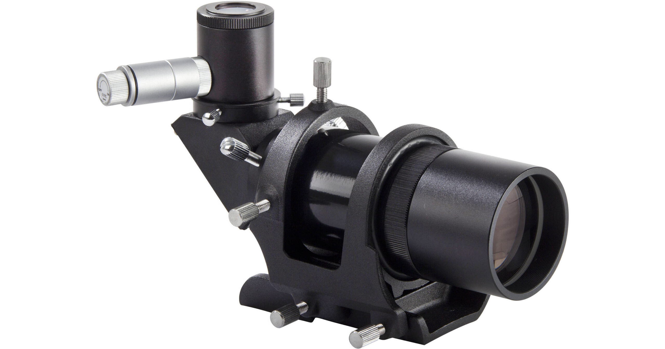

Whatever brand or style of finder scope you use, be sure to align it with your main scope before it gets dark. Credit: Celestron

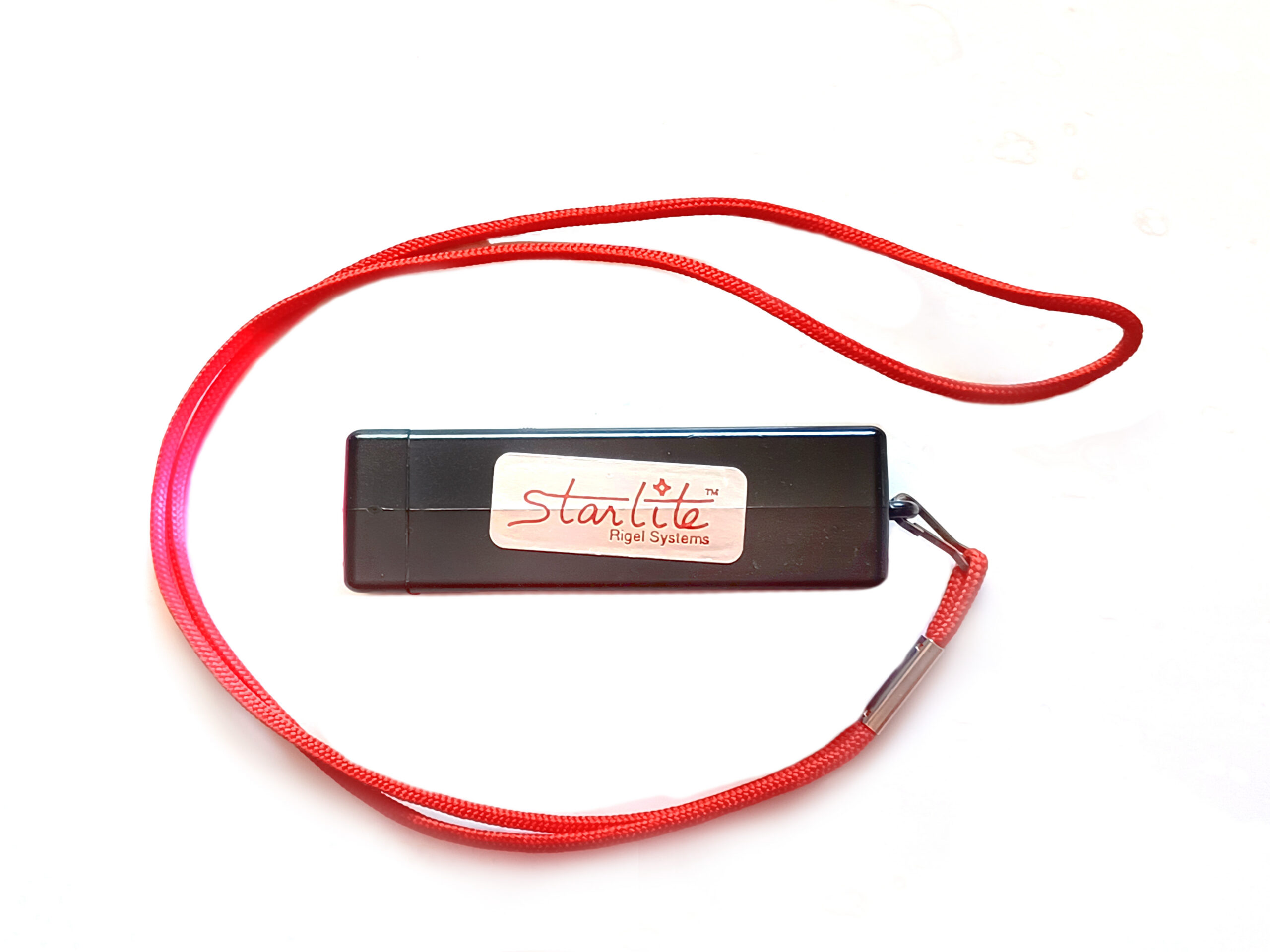

The Starlite by Rigel Systems is a good choice for an observing light. It has two red LEDs and is dimmable over a nice range. Credit: Michael E. Bakich

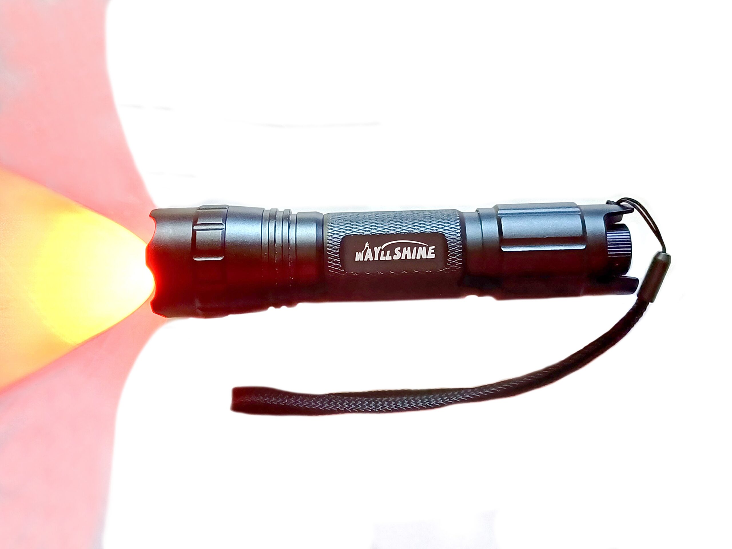

A great choice for an observing light is the Wayllshine Red LED Flashlight. Although the light in this image appears yellow, in reality it is intensely red. Credit: Michael E. Bakich

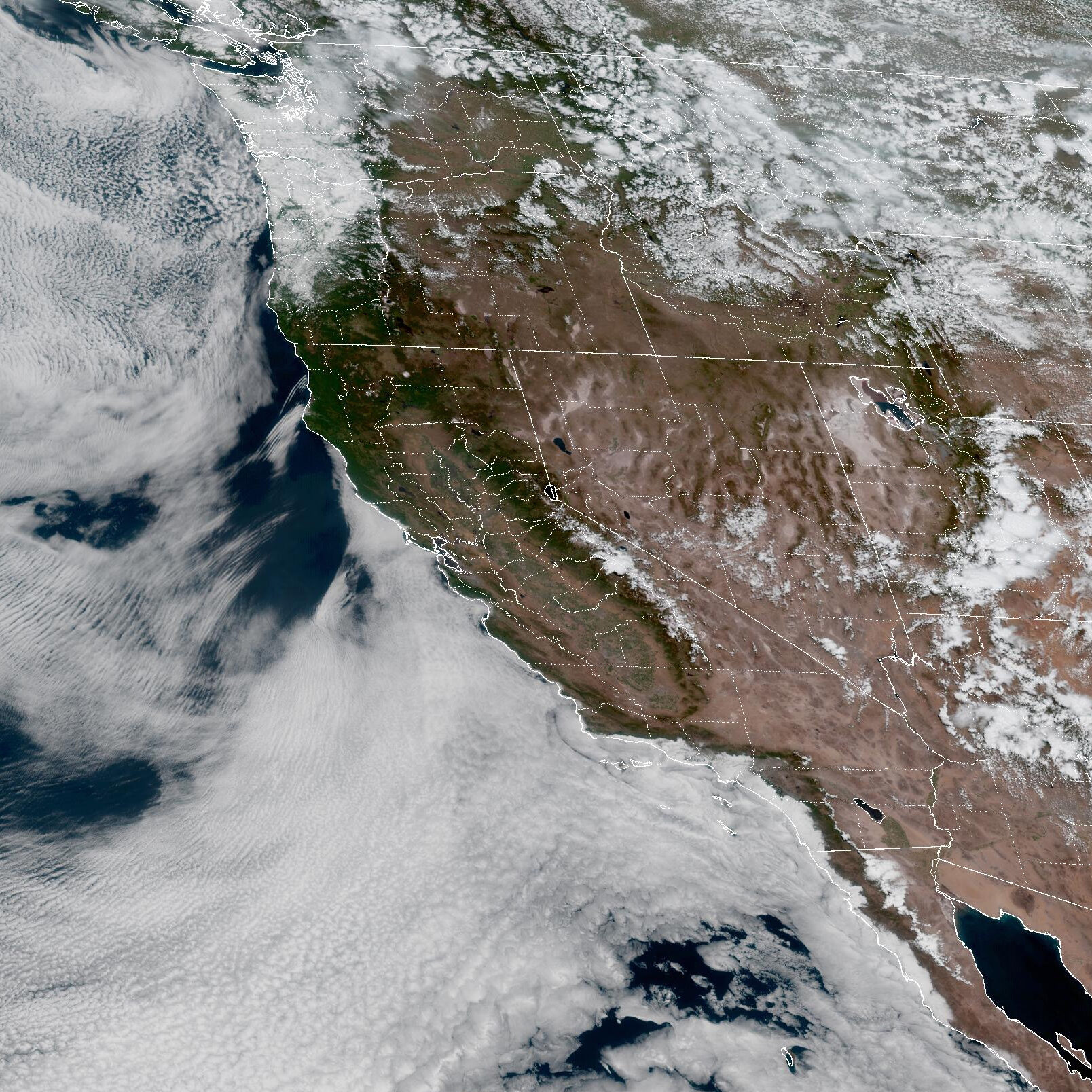

Satellite maps of the area where a star party will be held can show current clouds. Many sites and smartphone apps also offer animations that let you see the directions the clouds are moving. Credit: CIRA/NOAA
