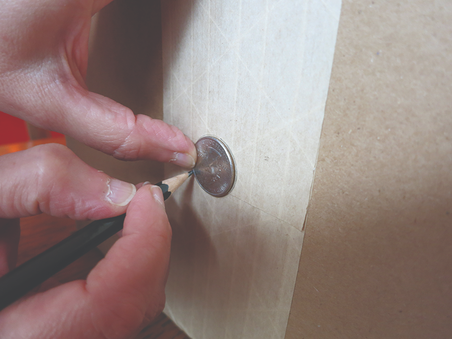

Step 2 in wow to make a pinhole viewer is to trace a quarter on one of the box's smaller ends.
Step 2: On one of the box’s smaller ends, trace a circle by using a quarter.

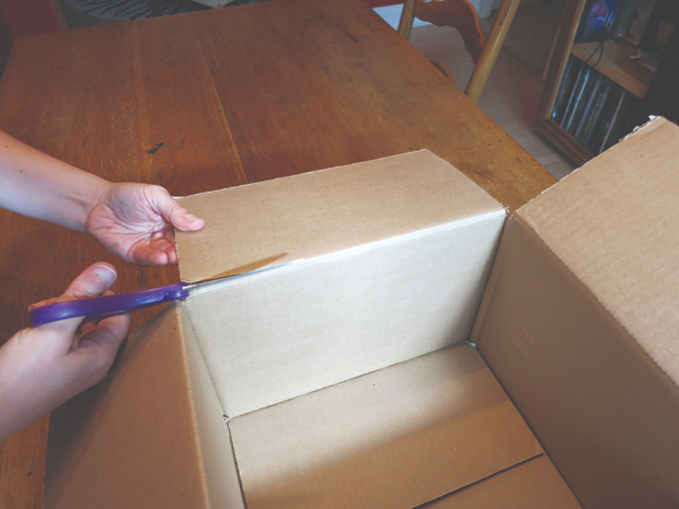

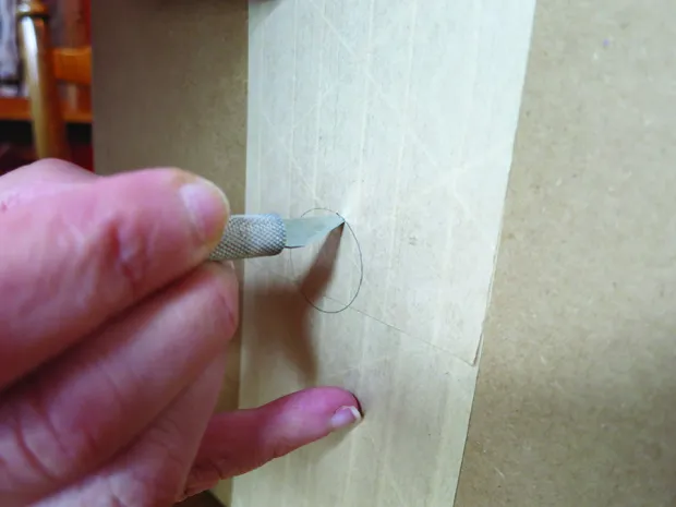

Step 3: Carefully cut out the circle with a sharp knife.

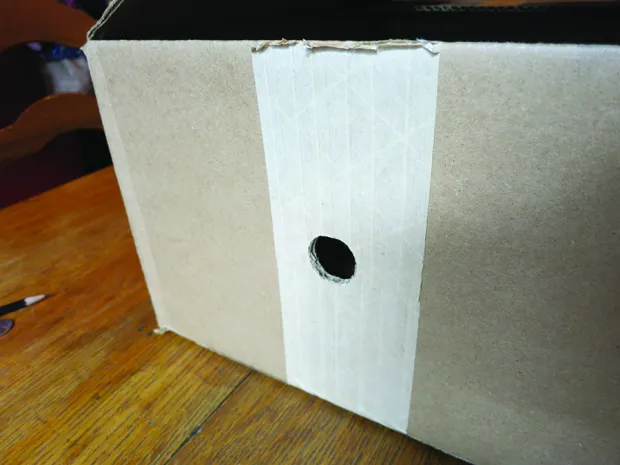

Step 4: Note that the hole doesn’t have to be perfect — or even round!

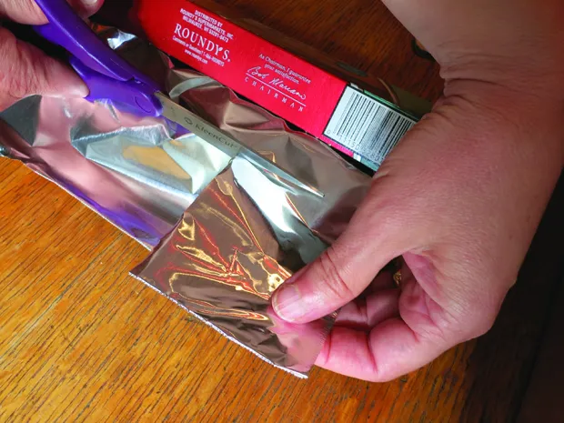

Step 5: Cut out a piece of aluminum foil (I used a fairly thick variety) big enough to cover the hole in the box.

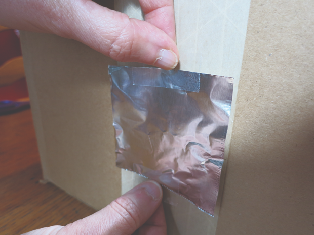

Step 6: Tape the foil over the hole.

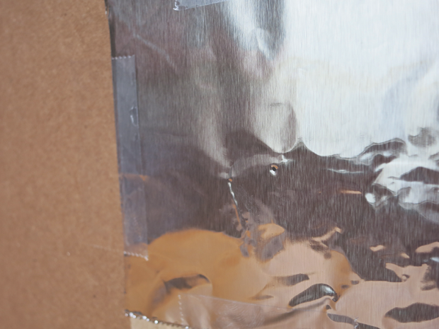

Step 7: Poke a hole in the foil using a pin. A pin is better than most items you could use because you want a hole with clean (non ragged) edges. As a variation, you can try using a sharp pencil. That will produce a larger hole. Careful, though. If your hole is too big, you’ll lose the pinhole camera effect and you’ll just see an out-of-focus blob.
Step 8: Inspect the hole for roundness and make sure nothing is blocking it.

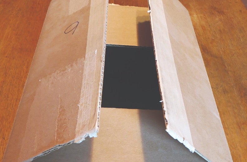

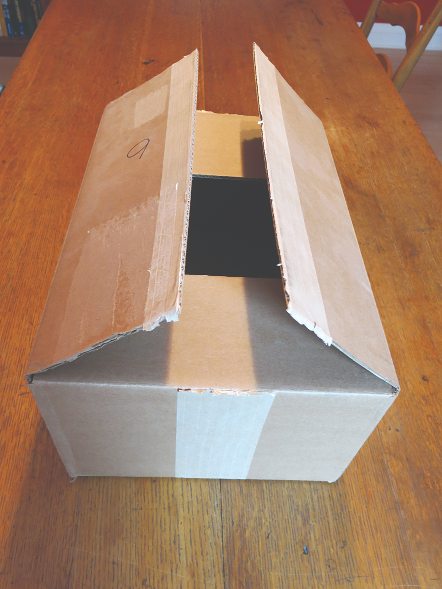

Step 9: Cut away as much of the extra cardboard pieces as you want. Alternatively, you could fold them over and tape them to the box’s sides, making the assembly a bit sturdier.

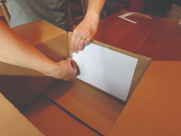

Step 10: Tape a white piece of paper on the inside of the box opposite the hole.

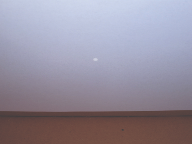

Step 11: Point the hole at the Sun and observe the projection on the paper. Congratulations!
