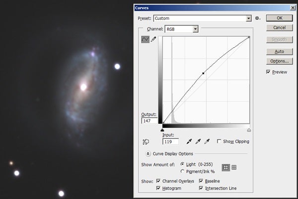

The adjustment in “Curves” is a simple one: Pull from the center of the line to form a shallow bow shape (image #4). Now unhide the upper luminance layer, and you’ll see some pale color. Although more applications of “Curves” and color saturation can achieve reasonable results, I’ve found that Photoshop’s “Shadows/Highlights” tool is an easier and more powerful way to do this.
The simplest way to brighten an image using "Curves" is to pull the line from the center point and form a shallow bow shape.
4. The simplest way to brighten an image using “Curves” is to pull the line from the center point and form a shallow bow shape. Remember to readjust the color saturation in your image after doing this.

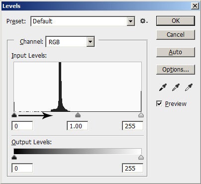

Finally, the color layer’s contrast is what ultimately controls the color in your blended result. At the start, you adjusted the white point just before clipping occurred. Without adjusting this, how do you change the contrast? Raise the black level (image #6) of the color layer.
Apply the “Shadows/Highlights” process, and then raise the black point in “Levels” to increase color in your image by sliding the house-shaped icon to the right.
6. Apply the “Shadows/Highlights” process, and then raise the black point in “Levels” to increase color in your image by sliding the house-shaped icon to the right. Do not touch the white point setting on the right.
Slide the house-shaped icon in the direction of the black arrow. This will increase the image’s contrast and bring more vibrancy to the picture. I always blend my color layer at 100 percent without sacrificing any detail in the luminance layer.
