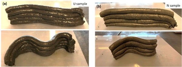

European researchers have found that the second-most abundant component of urine — urea — can serve as an effective plasticizer that helps keep 3D-printed structures workable while still maintaining their strength and stability during hardening. Plasticizers are often used in geopolymers (think ceramics or simple concrete) because they make the initial mixture easier to shape while avoiding dilution with too much water, which would weaken the final product.
By combining simulated lunar soil with water and urea, the researchers made 3D-printed geopolymer cylinders that outperformed versions that didn’t include a plasticizer. The researchers also compared their urea-based samples to versions made with more common, polycarboxylate- and naphthalene-based plasticizers. The team found the urea versions could support heavy weights, largely maintain their shape, and withstand eight freeze-thaw cycles (like those lunar bases would experience) about as well as the versions made with the standard plasticizers.
