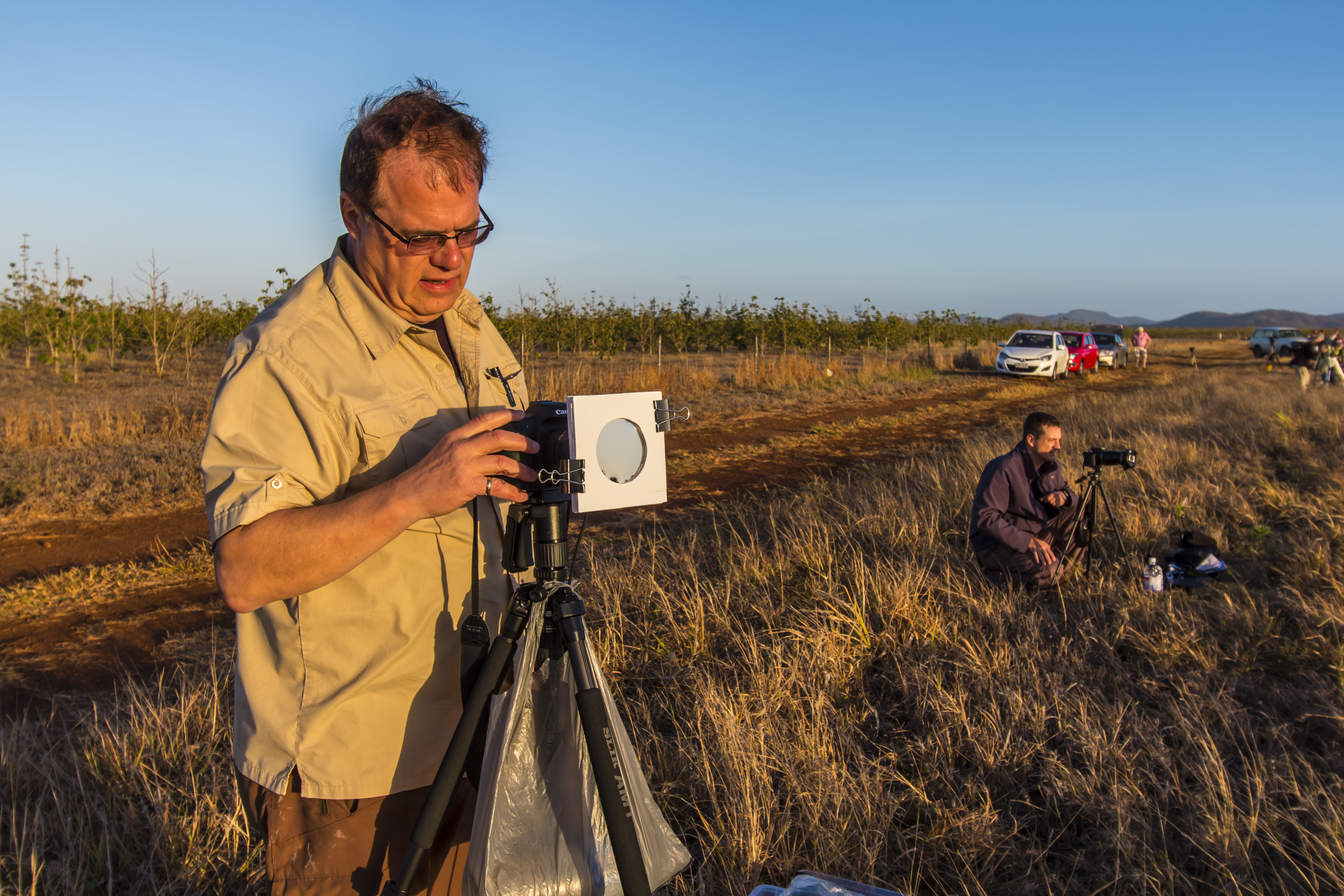

2.  Practice as much as you can
Don’t take your first pictures of the Sun on eclipse day. Take some test shots first. To do that, go outside on a sunny day, aim your filtered camera at the Sun, and shoot. (NOTE: When not looking through your filtered optics, wear solar glasses to protect your eyes as you look toward the Sun.) Set your lens to a fixed aperture — somewhere between f/8 and f/16 — and take a range of exposures. Examine the images and narrow them down to the best two or three. That’s when to look at the EXIF data, where all the shooting details will be. Remember, the Sun remains bright throughout the eclipse, so you won’t have to change exposure times until the disk is a thin crescent. At that point, add two more exposure stops.
Preparing
a camera for the Nov. 14, 2012, total eclipse over Australia.
Preparing a camera for the Nov. 14, 2012, total eclipse over Australia. Credit: Alan Dyer

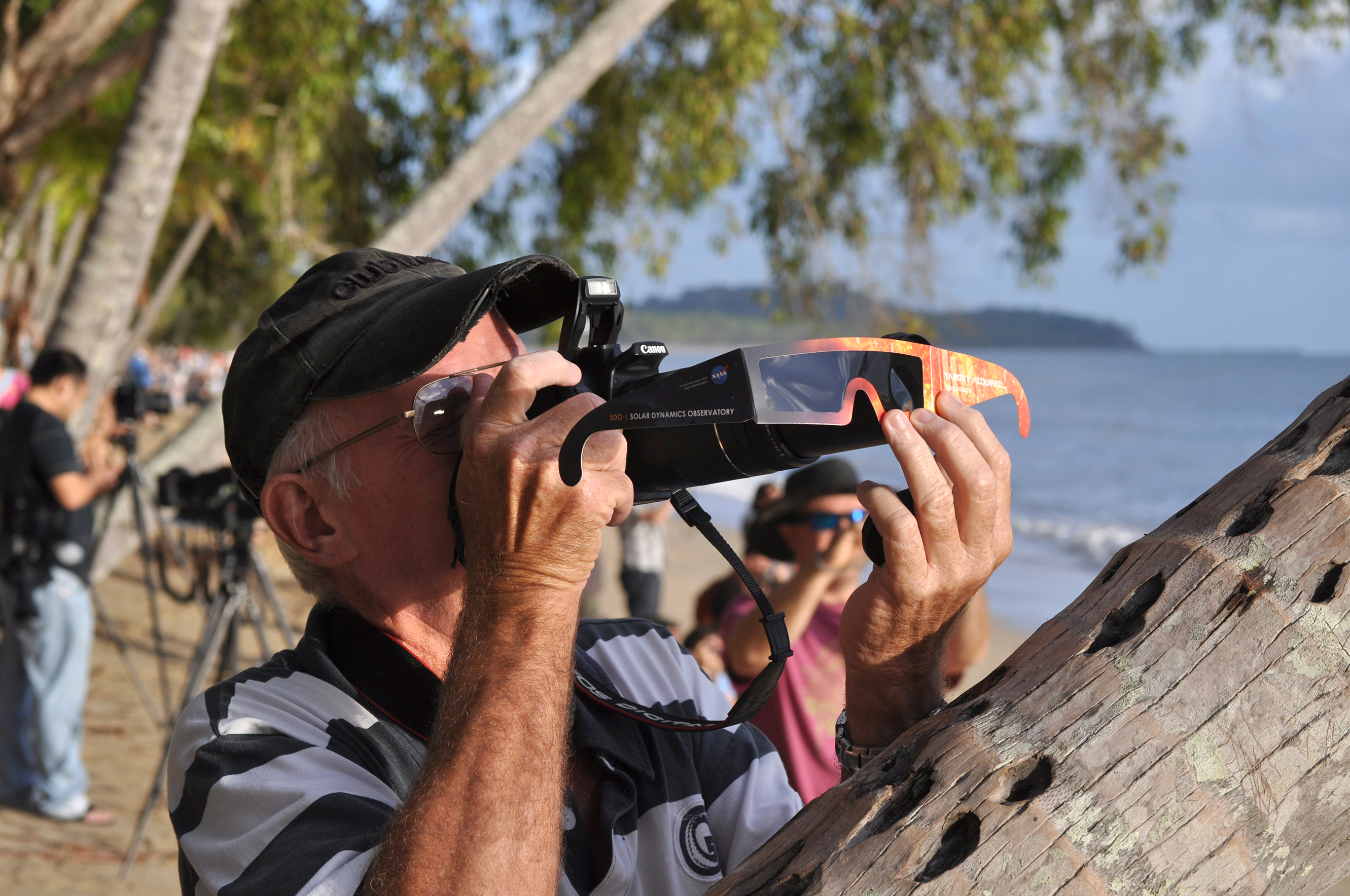

7.  Use an approved solar filter
As should be clear from how often it’s repeated, viewing and photographing the eclipse must only be done through an approved solar filter. For solar glasses, look for the ISO 12312-2 rating — the international standard for direct solar viewing. For your eyes to be safe when viewing through a filtered camera, stricter standards apply. The filter — which goes on the front of your optics — must reduce the visible light by a factor of 128,000.

Do not use eclipse glasses as a replacement
for a solar filter when photographing totality.
Do not use eclipse glasses as a replacement for a solar filter when photographing totality. Credit: Romeo Durscher/NASA Goddard/flickr

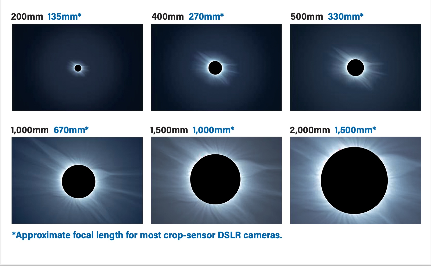

14.  Camera/lens field of view
Many DSLRs exist today, and they all accept a variety of lenses. Plus, not all of them have the same size sensors (chips). Here is an easy way to figure out a lens’ field of view (FOV) on your camera: FOV = 2 * arctan (0.5 * s/f) * 57.3. In this equation, s stands for sensor dimension in millimeters and f is the focal length of the lens in millimeters. Note that this formula is for just one dimension (width or height) of your chip. If you want the FOV in both dimensions, do this calculation twice. (Refer to “Choosing a camera for eclipses,” in the December 2023 issue, for more details.)
The illustration shows an eclipse at different focal lengths on a full-frame and a crop-sensor DSLR.
The illustration shows an eclipse at different focal lengths on a full-frame and a crop-sensor DSLR. Credit: Courtesy of Fred Espenak, www.MrEclipse.com
