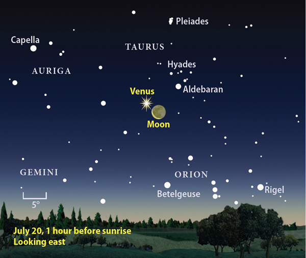

You won’t need any help finding Venus before dawn. The brilliant planet shines at magnitude –4.2 in early July and dims just 0.2 magnitude by month’s end. It rises around 3 a.m. local daylight time and climbs some 20° high in the east an hour before sunup.
You’ll want to follow Venus as it treks eastward against the backdrop of Taurus the Bull. The planet passes 7° south of the Pleiades star cluster (M45) in July’s first few days and then traverses the northern edge of the Hyades cluster at the end of July’s second week. You’ll find it 3° due north of 1st-magnitude Aldebaran, the Bull’s orange-colored luminary, on the 14th.
As Venus continues its march, it meets up with a waning crescent Moon on July 20. The two lie 3° apart and make a spectacular pair in morning twilight. The planet then passes less than 1° south of the Crab Nebula supernova remnant (M1) on the 26th and 0.4° north of 3rd-magnitude Zeta (ζ) Tauri the following morning. Venus spends the final two days of July in the narrow northern sector of Orion.

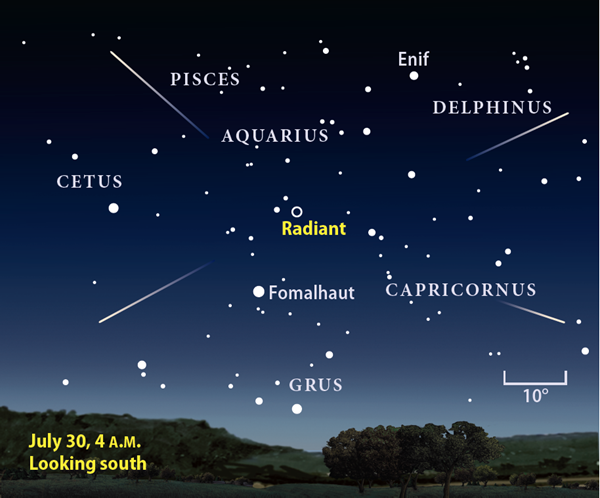

This year, meteor viewing should be better in late July. The Southern Delta Aquariid shower peaks the morning of July 30, when the First Quarter Moon sets just after midnight local daylight time and leaves the predawn hours free from its unwelcome light. Under a dark sky, observers can expect to see up to 25 meteors per hour, and rates stay above 20 per hour from July 27 to August 1. The best views come from equatorial and Southern Hemisphere sites, where the radiant, which lies in the constellation Aquarius, climbs higher in the sky.
