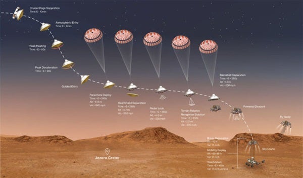

Landing on Mars requires a tricky set of maneuvers. In the final step, the Skycrane must deposit the rover on the Martian surface before zooming off.
NASA/JPL-Caltech
When the Perseverance rover hits the Red Planet’s atmosphere today, it will be traveling at more than 10,000 miles per hour (16,000 kilometers per hour). That’s so fast that the rover would vaporize like a meteor if it weren’t safely tucked inside a heat-resistant, carbon fiber capsule that can withstanding temperatures up to a whopping 1,600 degrees Fahrenheit (870 degree Celsius).
These extreme temps are only the first challenge Perseverance will face during its death-defying plunge. Next, it needs to deploy its enormous supersonic parachute. Yet Perseverance’s parachute can only slow the craft to about 200 mph (320 km/h). And if it landed at that speed, the rover would create a nearly $3-billion crater.

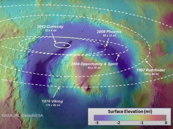

Planned landing ellipses of previous Mars rovers. Note how much smaller Curiosity’s landing zone is — thanks to the Skycrane maneuver — compared to previous rovers.
NASA/JPL-Caltech/ESA
According to Steltzner, the overall skepticism surrounding the Skycrane notably changed after his talk at NASA headquarters. Previously, other engineers and space centers were hesitant to seriously support the wild idea. But with the administrator’s comments, that reluctance faded away. And as planning for the Curiosity mission pushed forward, NASA threw its full support behind the effort, Skycrane included.
“If you’re landing a rover on Mars, there’s no doubt this is the right way,” Steltzner says.
The rovers are built to handle rough terrain. So, when the Skycrane drops it off at speed, it’s not significantly different than stumbling off a large rock. In fact, both Curiosity and Perseverance are tough enough that they could survive even if the Skycrane dropped them right on top of a small boulder. The Skycrane let NASA’s robotics engineers design a rover that could navigate the surface without worrying about having to make compromises just for its landing.
The technique has also proven to pair nicely with radar sensors that let the spacecraft observe its surroundings and autonomously guide itself to a safe area. This allowed the Curiosity rover to hit a relatively tiny landing target on Mars, and Perseverance will use a similar — yet even more precise — approach.
