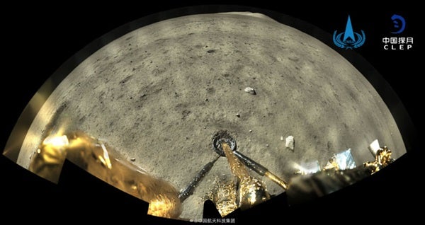

Chang_e5onthemoon
This image from the Chang’e 5 lunar lander shows off its spindly, Apollo-like legs.
CNSA
The downside of missions that utilize LOR is that the actual rendezvous above the Moon is tricky and has to work perfectly — otherwise the entire mission will fail. Chang’e 5 was able to perform this rendezvous autonomously using microwave radar, whereas Apollo missions relied on their human pilots to dock their spacecraft manually. Indeed, the main function of the lone astronaut remaining in lunar orbit in the Command and Service Module during the Apollo missions was to be able to rescue the moonwalkers from a low or erratic orbit should they encounter troubles after lifting off from the moon itself.

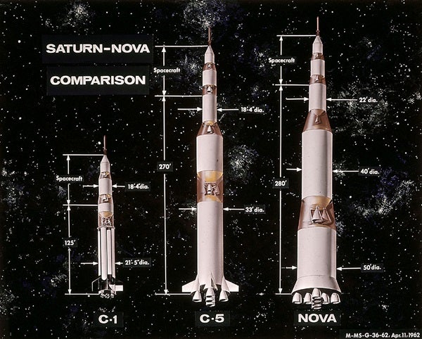

Saturn_Nova
To fly a direct ascent mission to the Moon, NASA considered building a rocket dubbed Nova (right) that would be significantly larger than the Saturn V rocket (depicted here in an early version, center). A predecessor rocket, the medium-lift Saturn C-I, is shown at left.
NASA
Direct ascent was notably featured in the 1950 science fiction film Destination Moon. In fact, before the Apollo program, direct ascent was how most lay people conceived of how a flight to the Moon would actually work.
The advantage of direct ascent is its simplicity, as it obviates the need for any rendezvous phases. The main, and largely insurmountable, disadvantage of direct ascent is that it requires an almost unfathomably massive spacecraft to make it work. NASA looked at a few different direct ascent spacecraft designs, but these were considered too large or unworkable.
