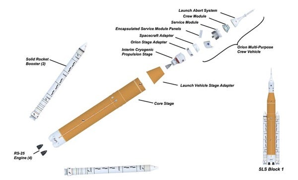

SLSstages
Stages of the SLS.
NASA
The core stage of the rocket is augmented by two solid rocket boosters, attached to its sides, providing a total combined thrust of 8.2 million pounds at launch – about 5% more than the Saturn V at launch. This will lift the spacecraft to low Earth orbit. The upper stage is intended to lift the attached payload – the astronaut capsule – out of Earth’s orbit and is a smaller liquid fuel stage powered by a single RL-10 engine (already in use by ATLAS and DELTA rockets) which is smaller and lighter than the RS-25.

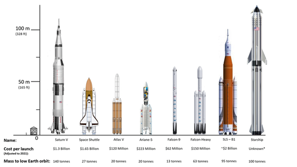

Rocketsizepayloadandcostcomparison
NASA’s SLS and SpaceX’s Starship, on the right, could both get us to the Moon and beyond.
n Whittaker/NASA/SpaceX, Author provided
