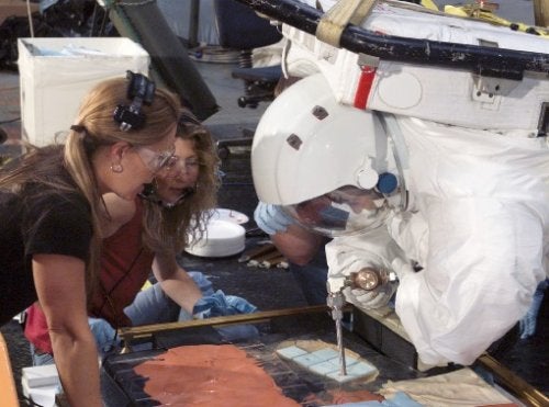

The CAIB report urged NASA to develop a way for astronauts during flight to inspect the orbiter and make emergency repairs to its insulation tiles and reinforced carbon-carbon panels.
At the briefing, however, space shuttle program manager Bill Parsons acknowledged setbacks in the most promising repair method. Testing has shown the adhesive used clings to the tiles but develops bubbles in a vacuum and might let go on reentry. As a result, Parsons said, the next shuttle flight, scheduled for May-June 2005, might be launched before engineers perfected a fixit kit.
“I would be very surprised if we had a certified repair technique” in time for the flight, Parsons said.
He noted that having a tested ability to make repairs in orbit is “not a requirement” for launch. If all else is in order, Parsons said, “we would fly with whatever capability we have.” Yet, he said, NASA hopes to have at least some kind of repair kit aboard, if only for testing.
