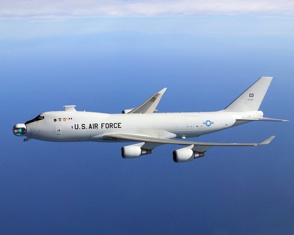

Lasers also find widespread application in military operations. One of the best known is the Airborne Laser (ABL), which the U.S. military intended to use to shoot down ballistic missiles. ABL involved a very large, high-power laser mounted on a Boeing 747. The program was ultimately doomed by the challenges associated with the thermal management and maintenance of its chemical laser.
planemountedwithlaser
The U.S. military experimented with mounting a powerful laser on a large jet aircraft, with the goal of shooting down incoming ballistic missiles.
U.S. Missile Defense Agency
