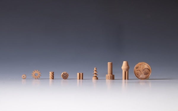

Researchers 3D-printed these pieces using fake moon dust, or regolith.
ESA–G. Porter, CC BY-SA 3.0 IGO

To support a potential future lunar base, researchers at the European Space Agency (ESA) have 3D printed and baked fake Moon dust into screws, gears, and even a coin.

To 3D-print with fake Moon dust, the team started with the human-made regolith. The dust was then ground down to particle size, and the resulting grains mixed with a binding agent that reacts to light. A 3D printer then laid the mixture down in layers until the desired object took shape. The item was then exposed to light so it could harden, and baked in an oven to fully solidify it.
The finished product is like a piece of Moon dust ceramic, ESA said in a statement. These initial pieces have proven that it’s likely possible to print with actual lunar regolith on a Moon base, and they’re part of the larger URBAN project examining how 3D printing could support lunar colonization.
