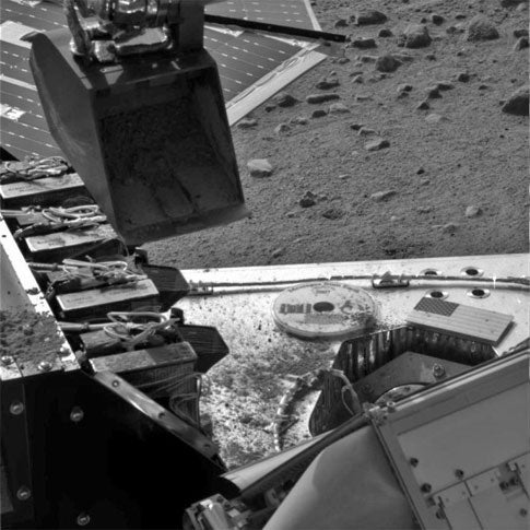

This image shows the lander’s robotic arm scoop positioned over the Wet Chemistry Lab delivery funnel on sol 29.
NASA/JPL-Caltech/University of Arizona/Texas A&M University

NASA’s Phoenix Mars Lander placed a sample of martian soil in the spacecraft’s wet chemistry laboratory yesterday for the first time. Results from that instrument, part of Phoenix’s Microscopy, Electrochemistry and Conductivity Analyzer, are expected to provide the first measurement of the acidity or alkalinity of the planet’s soil.
