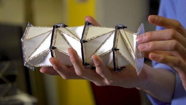

The series of paper cells developed by researchers at the University of Washington uses origami folds to absorb the force of impacts.

That’s the idea being pursued by Hiromi Yasuda and colleagues at the University of Washington. They’re using foldable materials inspired by origami to not only absorb the shock of impact, but actually change it into a force that travels back in the opposite direction. While the prototypes are made out of paper, the researchers say that many different materials could be used, possibly changing how rockets land in the future.

Yasuda’s team came up with a unique cell that twists and folds, absorbing the force of an impact. They then connected 20 of the cells into a column, and glued caps onto each cell. (Glue is generally discouraged in more traditional origami art, but in engineering labs, it’s apparently okay.) The team filmed the finished product as it was compressed from one end, sending a wave of compression through each of the cells.
Tracing the wave, the researchers found that the complex array of folds stacked on top of each other actually managed to turn the pushing force from the compression into a pulling force.
“If you were wearing a football helmet made of this material and something hit the helmet,” said Jinkyu Yang, a co-author on the paper, “You’d never feel that hit on your head. By the time the energy reaches you, it’s no longer pushing. It’s pulling.”
