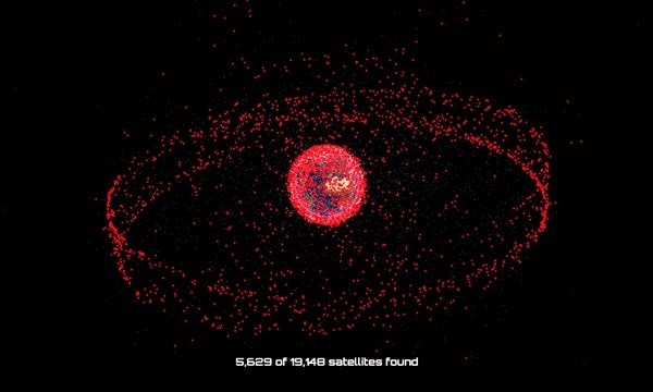

media_Psatellitemap
Thousands of working satellites (shown in red) are circling the globe at this moment. Many could become space junk if they can’t be repaired and refueled.
