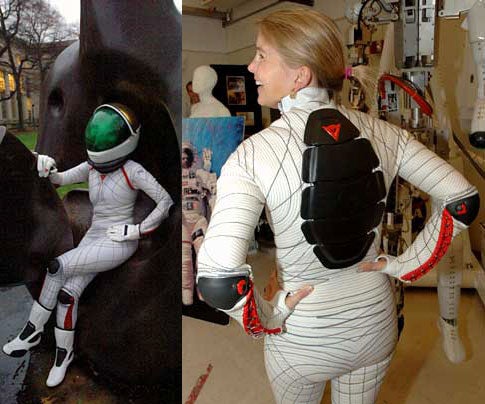

Dava Newman models her BioSuit, a sleek spacesuit that relies on mechanical counter-pressure instead of gas pressurization, on the MIT campus. The back of the suit, at right, can accomodate an oxygen tank.
Donna Coveney

Newman is working on a sleek, advanced suit designed to allow superior mobility when humans eventually reach Mars or return to the moon. Her spandex and nylon BioSuit is not your grandfather’s spacesuit — think more Spiderman, less John Glenn.

Newman says the finished BioSuit may be a hybrid that incorporates some elements of the traditional suits, including a gas-pressured torso section and helmet. An oxygen tank can be attached to the back.

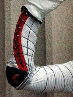

A detail of the Biosuit shows lines of non-extension sewn into the suit’s fabric.
Donna Coveney
The MIT researchers are focusing on the legs and arms, which are challenging parts to design. In the Man-Vehicle Lab at MIT, students test various wrapping techniques, based on 3D models they’ve created of the human in motion and how the skin stretches during locomotion, bending, climbing, or driving a rover.
Key to their design is the pattern of lines on the suit, which correspond to lines of non-extension — lines on the skin that don’t extend when you move your leg. Those lines provide a stiff “skeleton” of structural support, while providing maximum mobility.
