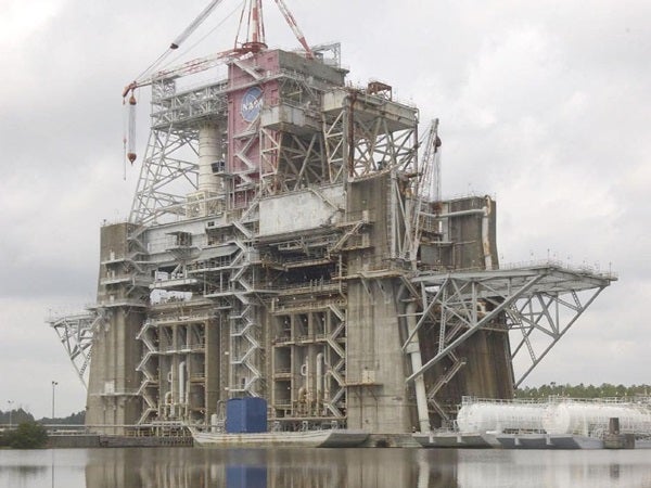

Stennis Space Center’s B-1/B-2 Test Stand is a dual-position, vertical, static-firing structure built in the 1960s. Soon, it will test the Space Launch System that will send humans into space. // NASA/SSC

The B-2 Test Stand at Stennis, originally built to test the Saturn rocket stages that propelled humans to the Moon, is being completely renovated to test the SLS core stage in late 2016 and early 2017.

The site’s engineers spent 18 months assessing the cost of the work needed to upgrade the B-2 Test Stand from Apollo- and space shuttle-era testing specifications. After NASA made the decision to proceed with renovations, engineers began the first of three project phases.
“In the first phase, we are restoring the test facility to its original design condition, where it could be used to test any number of stages,” Rauch explained. “In the second phase, we will focus on building out the stand specifically to accommodate the SLS core stage. Then, in the third phase, we will complete the structural, mechanical, and electrical interfaces.”
In the end, no area of the stand will be left untouched.
The SLS stage is different from the Saturn and space shuttle propulsion systems. It is taller, standing 212 feet (65 meters). Engineers thus will have to extend the derrick crane atop the stand 50 feet, modify the weight and thrust takeout structures, and erect a higher support frame. The process will involve repositioning an existing 1.2 million-pound (544,300 kilograms) frame by some 20 feet and building a new 100-foot-tall (30 meters) superstructure atop it.
