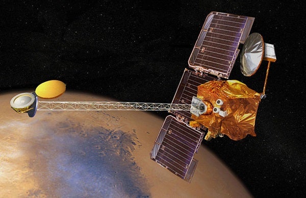

For more than 20 years, NASA’s Mars Odyssey orbiter has been circling the Red Planet, mapping the martian surface to help astronomers untangle the mysteries of Mars’ history.
But in January 2022, engineers calculated that Odyssey only had enough propellant to last about 12 more months. It appeared that after traveling some 1.37 billion miles (2.21 billion kilometers) and looping around the Red Planet more than 94,000 times, Odyssey’s mission would soon come to a close.
Fortunately, that’s no longer the case. According to a recent NASA news release, new estimates suggest Odyssey actually has enough remaining propellant to last through at least the end of 2025.
A spacecraft without a fuel gauge
Mars Odyssey orbiter launched in 2001 with nearly 500 pounds (225 kilograms) of hydrazine propellant. In order for Odyssey to keep its science instruments trained on the martian surface, the spacecraft depends on three spinning reaction wheels to create internal torque.
“These reaction wheels have to work together to maintain the spacecraft’s pointing,” Jared Call, Odyssey’s mission manager at NASA’s Jet Propulsion Laboratory (JPL), said in the release. “But with Odyssey completing a full loop every orbit, you need a way to unload the increasing momentum.”
That’s where Odyssey’s thrusters and the hydrazine propellant come into play. In order to counteract the building momentum of the reaction wheels, the spacecraft’s thrusters fire out hydrazine propellant in short bursts.
