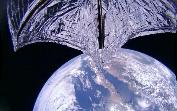

LightSail 2 took this picture of itself, with Earth in the background, while deploying its sail on July 23.
The Planetary Society
