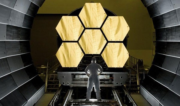

JWSTmirror
The James Webb Space Telescope mirrors sit outside a testing chamber in 2011.
David Higginbotham/NASA
