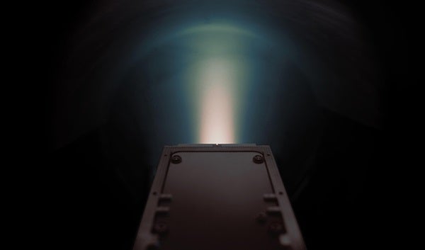

A satellite iodine electric propulsion system firing in a vacuum chamber.
Courtesy ThrustMe
